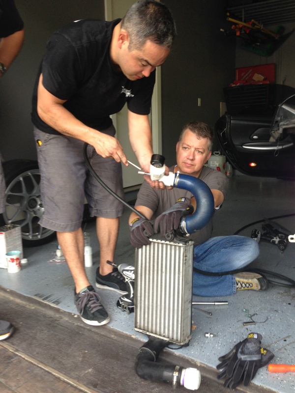

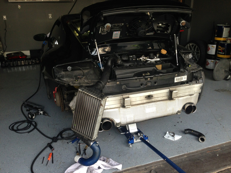

We did some work on two 996TTs today in my garage. Dustin's (black car) has a EVOMS 600 kit but it has never seemed to run that strong. We used my home made boost leak kit to reveal that it had two HUGE leaks. The passenger side lower boost hose was almost completely off. The second leak we found was a faulty fuel check valve that was allowing boost pressure to escape back into the turbo intake. Markski from 911tuning was able to help identify the leak via some texting. It took us a while to find the leak, we first thought it was a intercooler end cap so we removed the intercooler from the car to check it out. This car just returned from a Porsche mechanic and neither issue was found, unfortunate.

When we got back from lunch, we started on Whereitsat's white 996. We had to set his wastegates to 18psi and do a boost leak test, no leaks. I used a hand pump to properly set each gate.

Ainslie is a great teacher, Houston's own Mr. Miyagi. If we didn't boost leak test, we would have never found Dustin's issues. Testing takes all of 30 minutes.

Best part of the day (besides a free lunch) was watching every one run for cover as my boost leak test plug popped off at 30 psi. Note to self, tighten the hose clamp more and test at 25....
