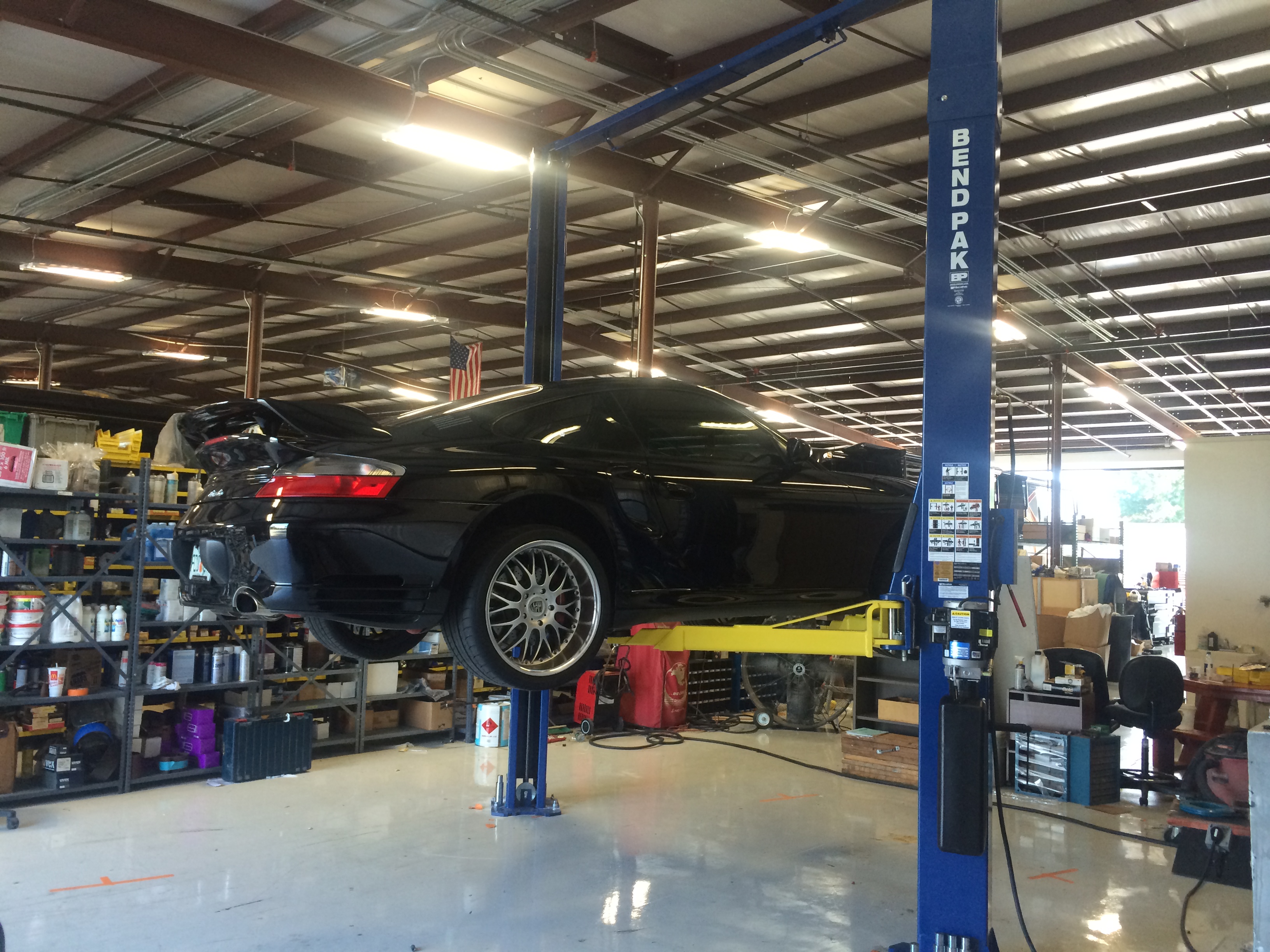

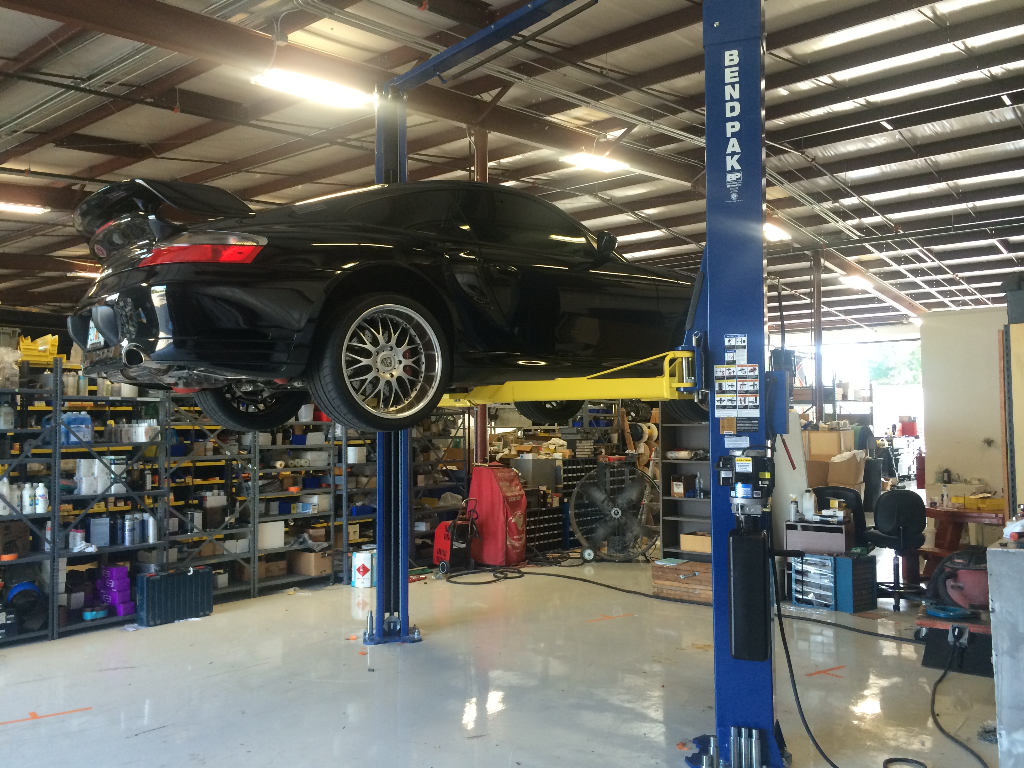

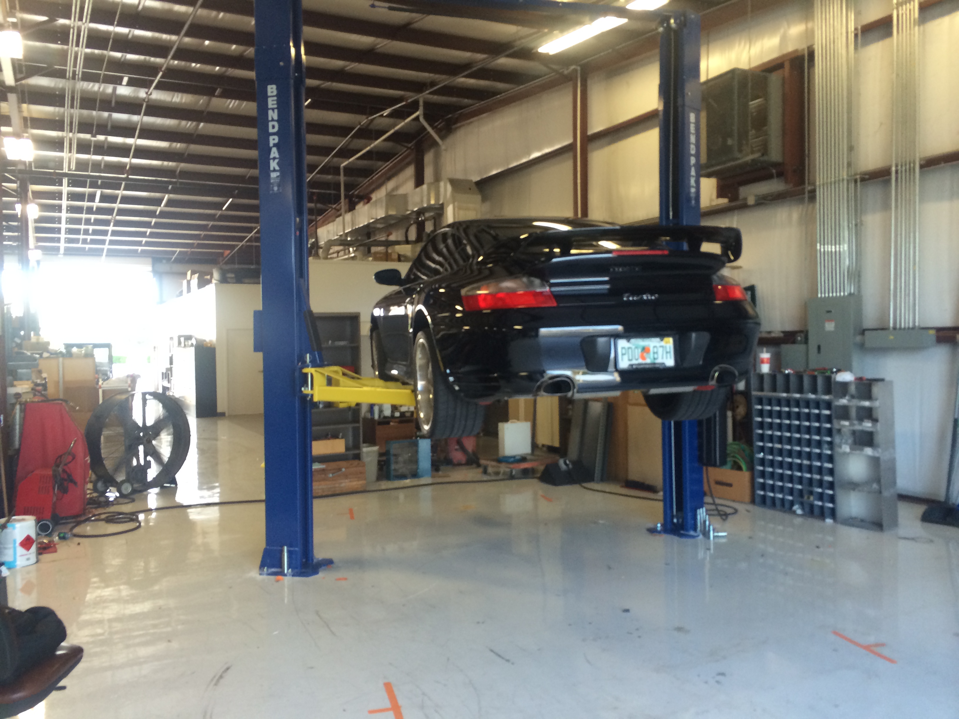

My troubles with my Tip started as a leaky gasket between the engine and transmission. After doing some research, I discovered that this has been a problem that others have experienced. It is said that most who have experienced the leaky Tip also experienced a bad tranny mount before the leak occurred. I don't know if that's the exact cause, but I did have a bad tranny mount. I ordered gaskets and removed the transfer case while tranny still attached to engine. It was a pretty straight forward job until I got to the decision to replace the filter and fluid or just top up with new fluid. Against my better judgment, I decided to change the filter. I filled tranny up properly by checking temp with both an infra-red temp gun as well as a wire probe attached to my Fluke. All went well and she shifted better than ever! Two weeks later with zero warning she flared badly shifting from third to fourth and slipped 4th and 5th

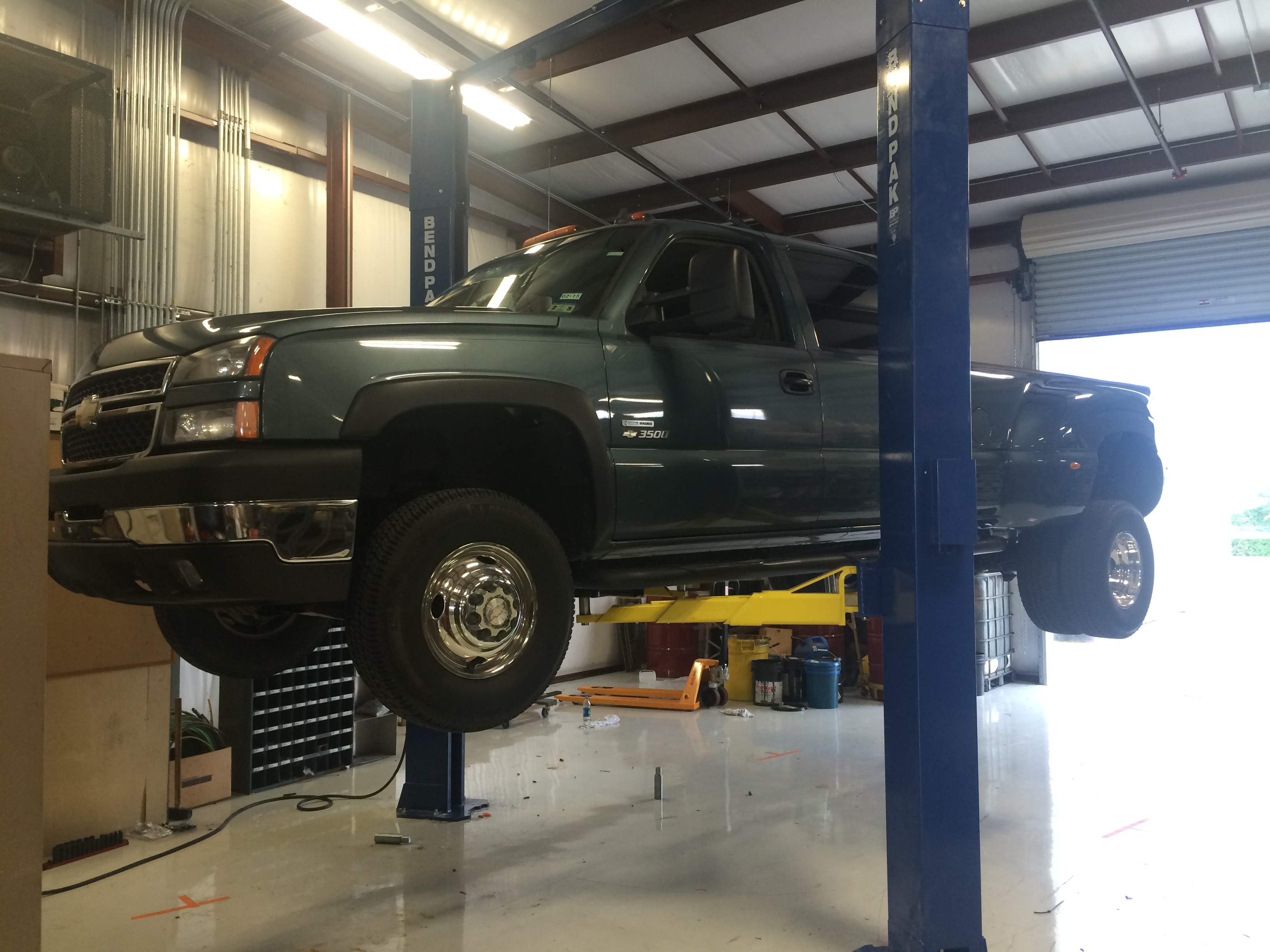

After checking around and considering a 6 speed swap, I have decided to pull tranny and send to Renntec for a full rebuild and upgrade as well as converter upgrade This decision, of course, inspired me to purchase a new lift! I ordered a new Bendpak 10k asymmetrical 2 post lift a week ago. A little overkill for the Pcar, but I will now be able to install tow bars and wire vehicles to be towed behind motor homes more efficiently than the guys having to jack up the vehicles!
Myself and two employees came in yesterday, unpacked the lift assembled it and installed it. We were lifting my dually by 6:00 pm
I plan on documenting my progress with pictures along the way. I would appreciate any and all suggestions!
BTW, please excuse the messy shop as we had to clean out a rather large area to install this lift! I will have this cleaned up this week
