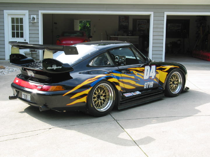

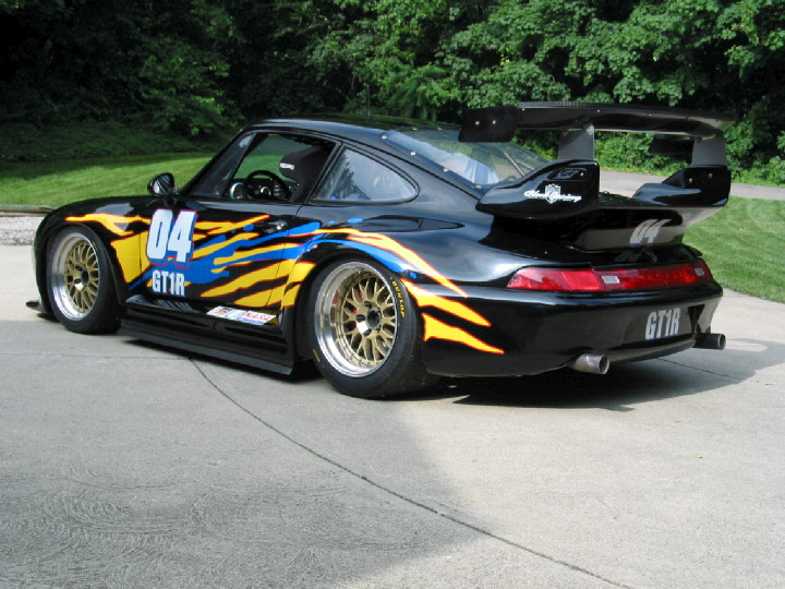

That's one hot looking 993 Norm! I saved the pictures.
Jean should look at this one.
Norm,
Those pics are awesome! If you guys get a chance to see Norm's car in person it's unbelievable!
