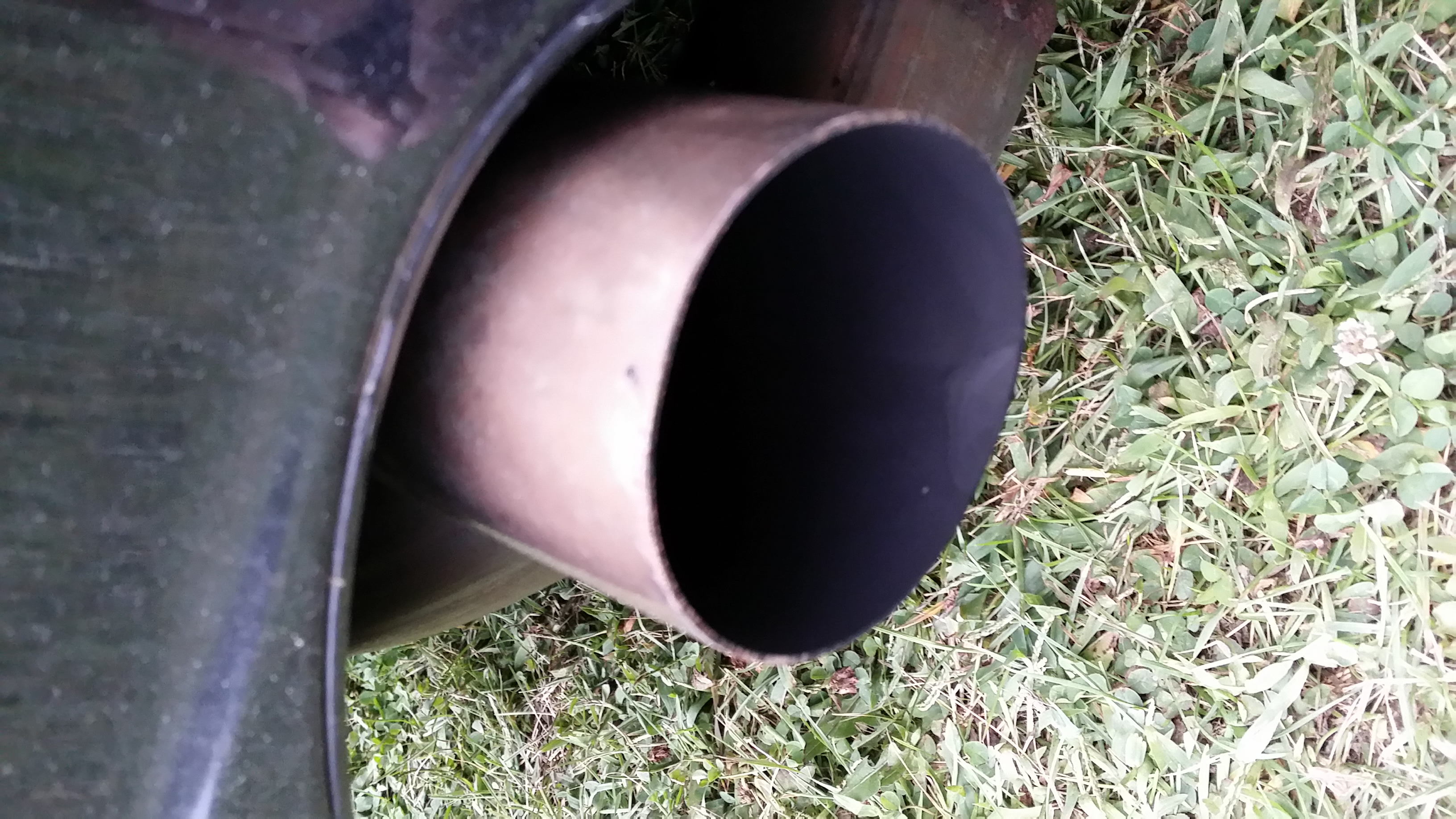

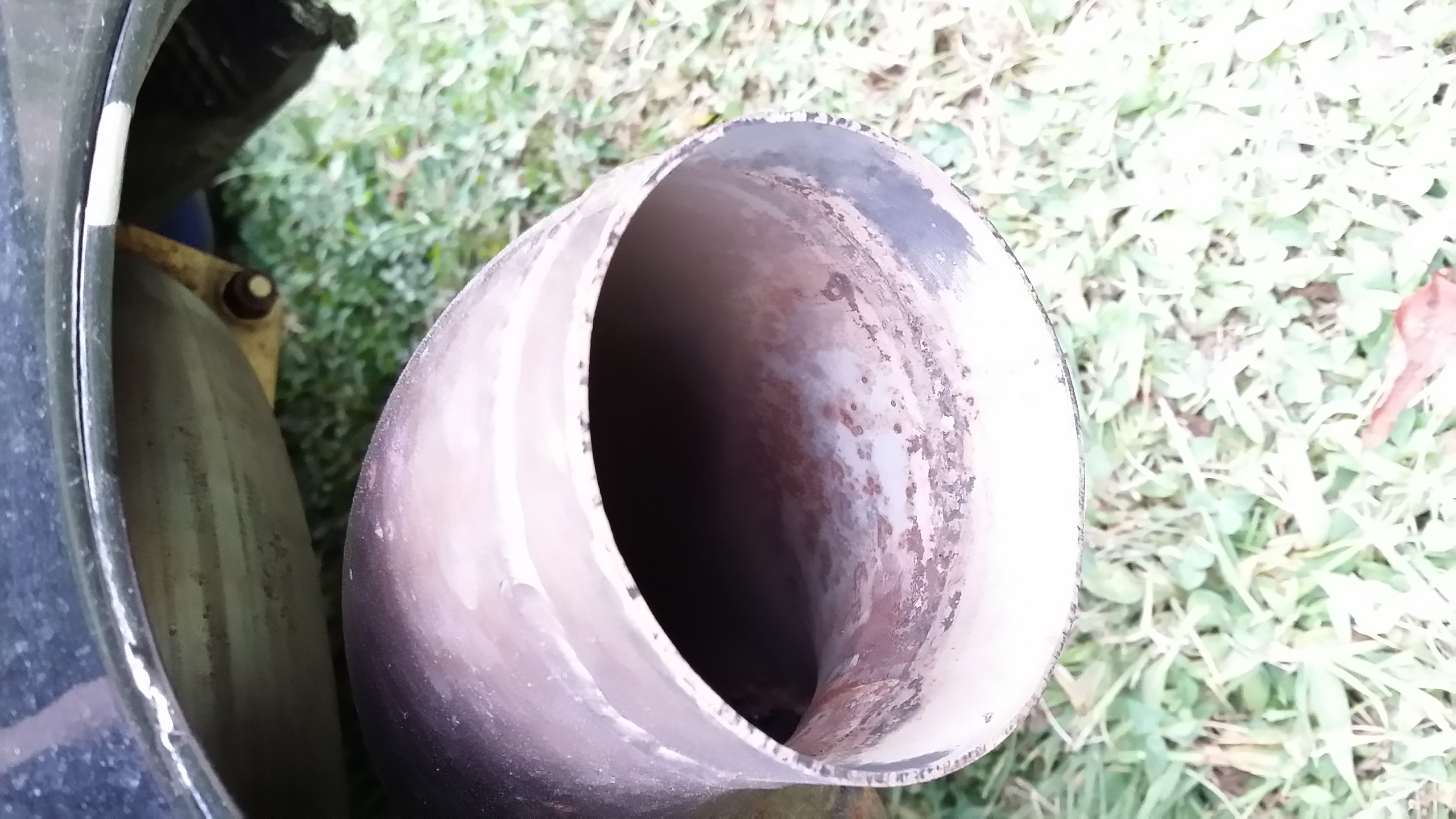

Running rough. Barely idling ...looks like one bank is effected. Lots of codes. Misfire misfire. Just changed the plugs last night. Exhaust tips looked like this when I got home.

You have a bank running rich did the car run fine before plug change.

Looks like one side is not firing at all and other us super rich or like timing is completely off.
What kinda noises is it making and what codes? I hope chain is ok.

Note the black exhaust is the normal one.... had a bad boost leek 2 weeks ago and now fixed. The perfectly clean one happened since lunch today.
