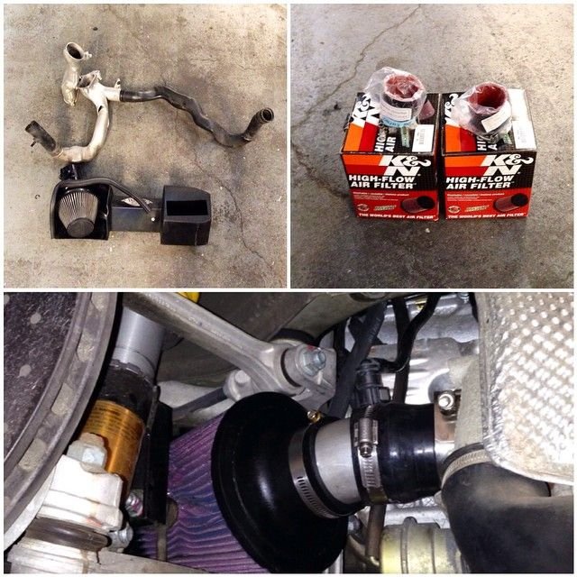

Added
MAFLESS tune with filters coming off the turbos, spools really quick now.
hand made intake piping with welded 2.5" ally u bend. Cone filters with shielding.
Replaced oil and filters
E85 pro tune in Eurodyne with 93 octane and 100 octane gas tunes.

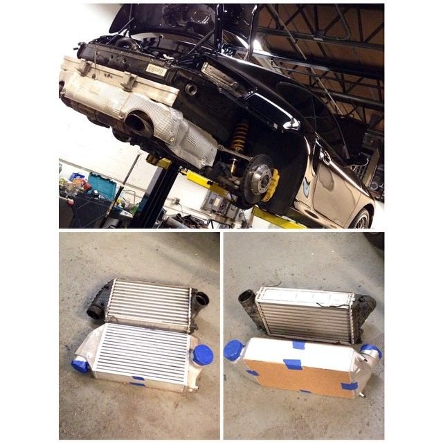

Added Extreme Turbo System (ETS) Intercoolers, which are spectacular. My IATs used to go from 27 C to 45 C on a 150 mph thrashing. The log I did with 18 C showed only a rise to 21C at max.
vbox verify is showing calculated bhp in the range 690-750 bhp at varying speeds, and around 730 bhp at 125 mph in 4th gear.
