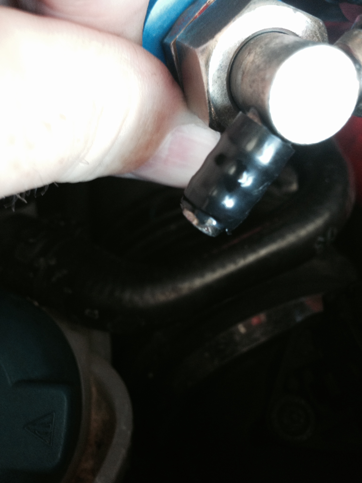

about a week ago the return line hose for the fuel filter failed. I managed to cut what I had hoped was the hole near the plastic u connector and put on a temporary clamp on it and got home, but barely.
I bought a replacement 5/16 line and after many hours managed to remove the hose from back of the fuel filter. I got the hose off and loosed the clamp holding the fuel filter in, but I couldn't get the fuel filter back in, so I removed the outflow hose which is in the front of the filter. it was pretty hard to do, which should have been my first sign. Second sign (in retrospect) was that there was no clamp on the outflow line.
after it cam off I saw that the metal nozzel was covered with some black plastic and then I looked inside the line and saw the same black plastic.
so what I'm look at appears to be a hose within a hose.
I don't think I can get to where the outflow hose terminates.
I could put a clamp on the connector, but I'm thinking the inner plastic hose is broken, it won't hold.
if I"m right, how is a fuel filter replaced?
seems like I may have taken a couple steps backward and gone beyond what I can do.
OTOH, if I can just clamp it, I can put it all back and be done.

here is a close up. the appears to be the same black plastic material in the hose part.

The line is fubar'ed.. The outer hose is just a jacket to protect the inner line. The other side of that hose goes to the fuel rail. Here is the partnumber for the line you need 996 110 315 73. I would think if you got this far you should be able to swap a fuel line. I would give you one if I had it, I cut them up and use the rail end to make a -6AN adapter out of it.

thanks, that's what I thought as soon as I saw it. the fuel filter outflow line connecting to whatever it connects to is not visible from the top of the engine. I can feel where it goes but I don't see how I can unscrew or remove it without seeing it. I have a mechanic's mirror and I guess I'll try that.
If it's removable by a mechanic with a good pair of hands. I might try to get the part and see if someone can help me.
If I can't do that, I'll try to find another tow company but the tow guy made me nervous since he said between the car being lowered and the very low bumper guard, he thought he'd ruin the bumper guard. I've only got a few inches clearance. pretty aggravating especially the part of making it alot worse.
so I could feel where it comes in. I think I could get a socket on it.
you know off hand what's the size?
If I can't do it, I think I could probably get someone to my house to do it.
now that I got the fuel filter out, seems not crazy hard to put it back.
thanks for the wise words. I'll order the part and see if I can do it.

use a 19mm open end wrench.

There should be no rubber fuel hose on anything if your car is stock. the feed line to the filter comes with the filter when you buy it. All the rubber fuel line you see in the engine bay is just a rubber jacket over the plastic fuel line.
