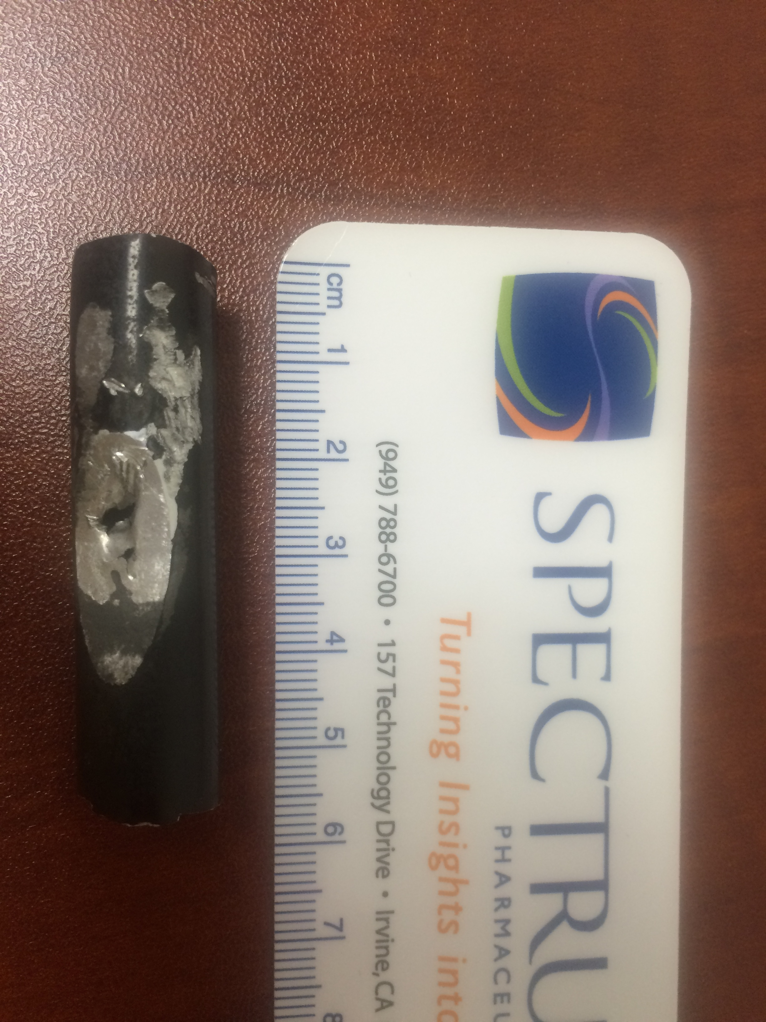

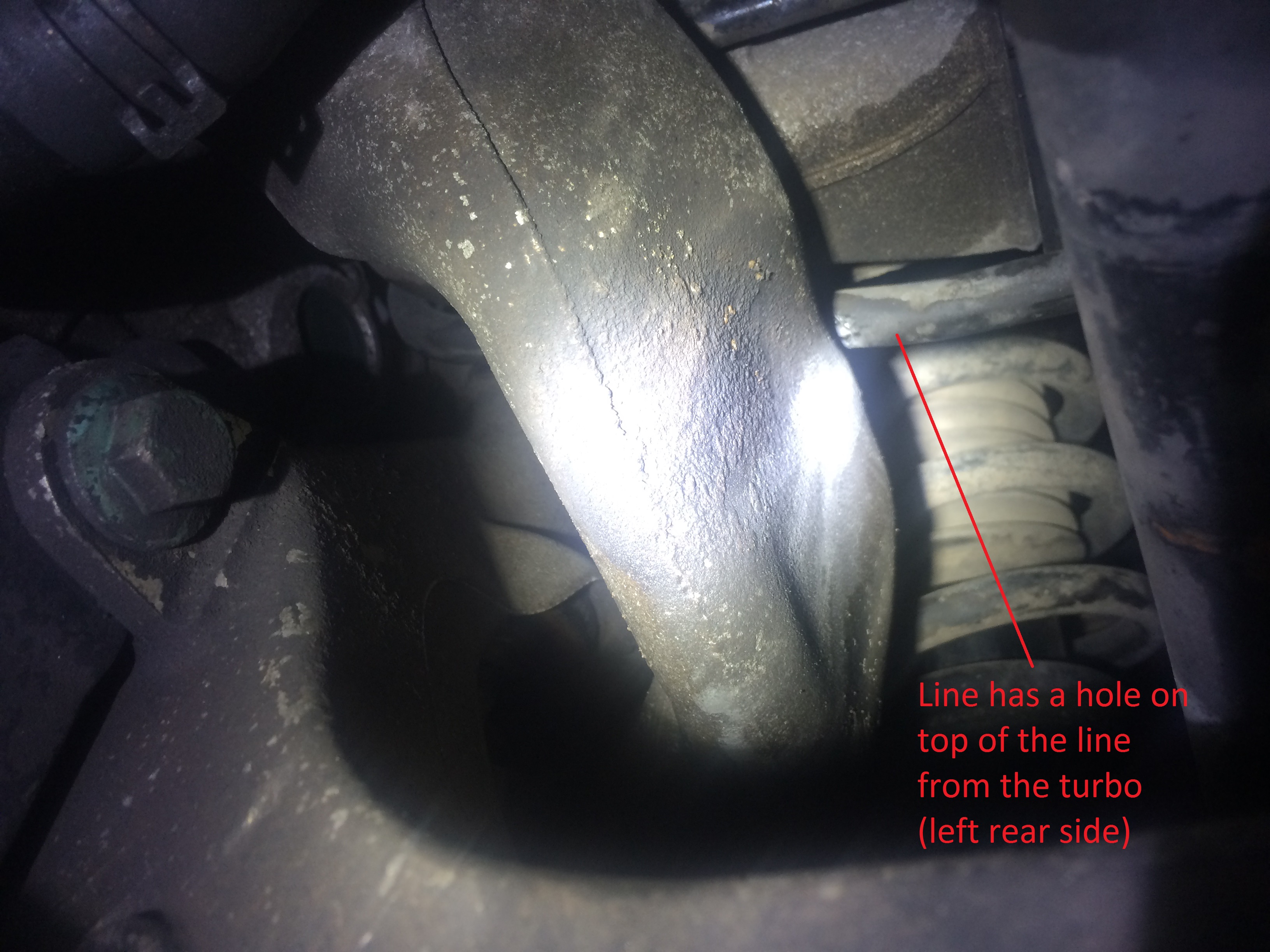

Update: Posted another photo below, which shows was the culprit. It seems odd that this line would sit directly on top of another metal part, but maybe there was a bracket that broke years ago, which allowed the two parts to rub together.
Edit: Post title and contents edited to better describe problem
I have a coolant leak due to a hole in a line that feeds the front radiators. This line sits on top of a metal tube that feeds the turbo; see photos. It's hard to see where this coolant line runs to as it move up the engine, and it doesn't appear possible to remove it without dropping the engine unless there's an access point from above.
Would appreciate someone showing me an image from the shop manual or describing an easy fix. One option is to cut the line from below where it is accessible and splice in a new one.

That looks like the bleed line that come from the top of the front radiators and heads back to the expansion tank. I would cut out the hole, roll a bead on both sides of the line and piece in silicone hose. use this tool:
http://www.jegs.com/p/Earls/Earls-EZ...40092/10002/-1
Engine does not need to come out.

Thanks. We'll give it a try.
