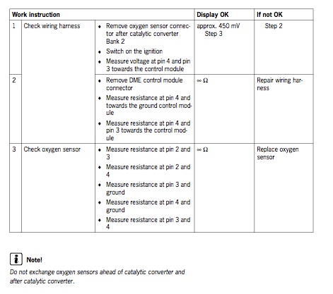

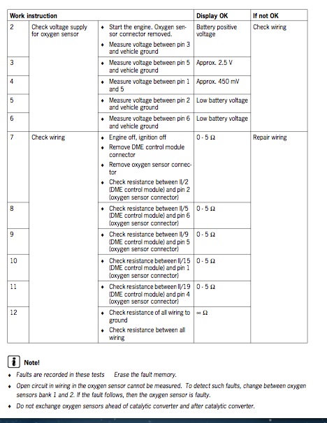

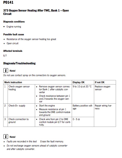

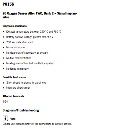

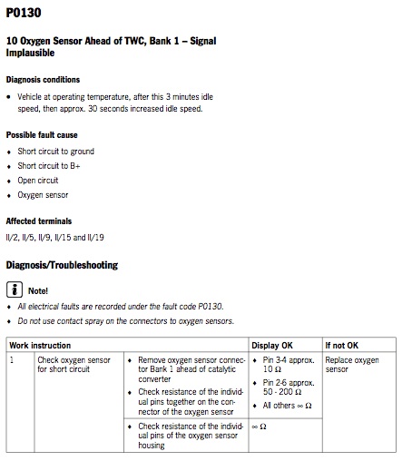

If you are dynoing the engine with suspected malfunctioning O2 sensors or questionable fuel delivery issues my advice is to stop that until you get sensors and fuel system sorted.
Let's see what the error codes mean:
P0130 - oxygen sensor ahead of TWC (three-way converter) bank 1 signal implausible.
P0150 - oxygen sensor ahead of TWC (three-way converter) bank 2 signal implausible.
P0141 - oxygen sensor heating after TWC bank 1 open circuit.
P0156 - oxygen sensor after TWC bank 2 signal implausible.
Too much to type in so I have attached some JPG's that contain text of tests. If you click on them they get bigger but let me know if they are not and I can email the JPG's to you via private email.
