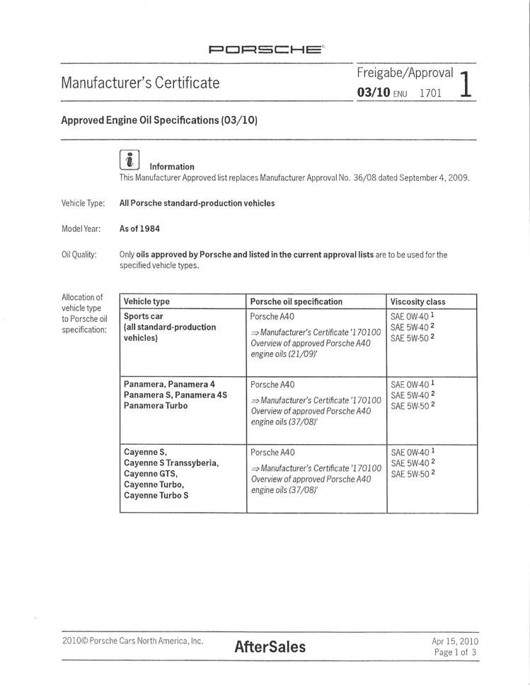

Where is that list?
Old Nov 20, 2014 | 11:39 AM
OEM's Avatar
OEM
Joined: Aug 2013
Posts: 53
From: Boise, ID
Rep Power: 15
OEM is infamous around these parts
"there is a list of other porsche approved oil too, including 15-40 M1, and castrol"
love it.

I'm sure it does, but I don't know how many things I've googled related to this over the past 1.5 days and I haven't seen a list from an official porsche website or porsche domain.

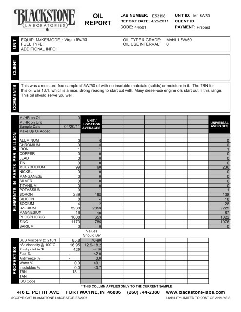

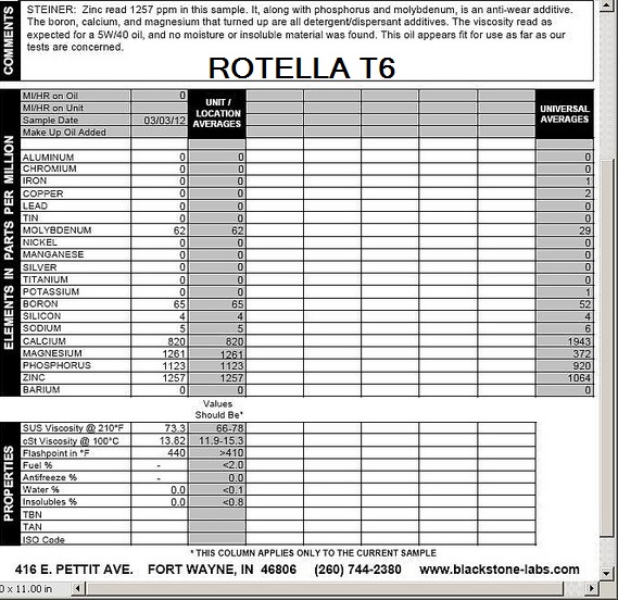

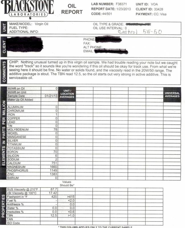

I posted this over on the sister-thread on RL...figure it's good to share here..
Name:	oil Castrol_Edge_5W-50_SN_zpsdd30420e.jpg
ID:	408022   Click image for larger version
Name:	oil M1_5W50_VOA_2.jpg
ID:	408023   Click image for larger version
Name:	oil T6 5w40.jpg
ID:	408024   Click image for larger version
