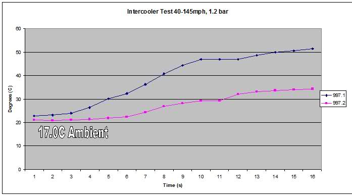

There are many tests that prove that the mk2/GT2Rs IC is quite much better then the old ones(see attached picture).
RS tuning tried a big Marston MS cores IC setup compared to what the result of big pod IC intakes did.. this was his comment afterwards...
"They were particularly interested in testing my car since it had similar intercoolers and similar engine specification (boost pressure etc) and they found that in 30C heat in 4th gear airflow (ie sub 130mph) my IATs were getting up to 60C whereas the race car in same sort of conditions with its big pods was getting no higher than 40C. "

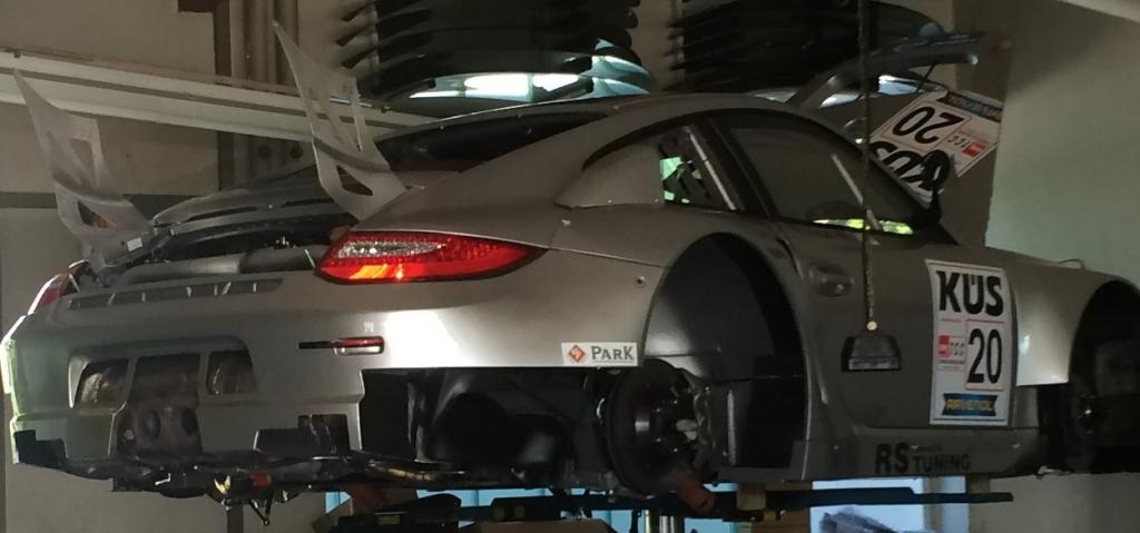

Pictures of the RS tuning 996TT wider ducts and the Racecar big Pod intakes..

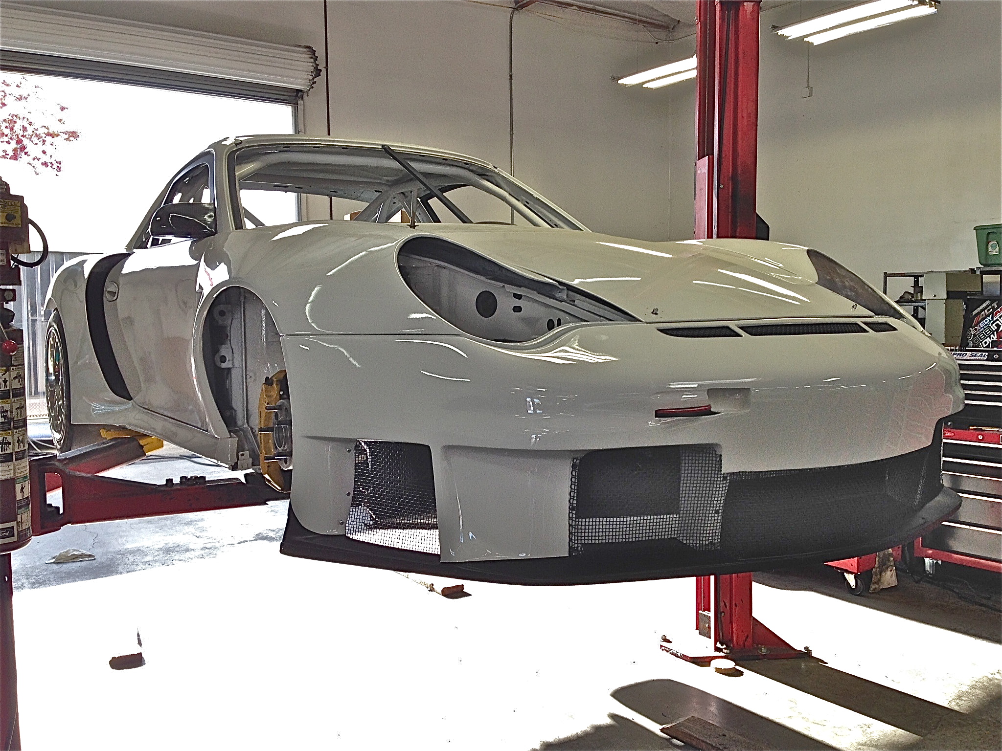

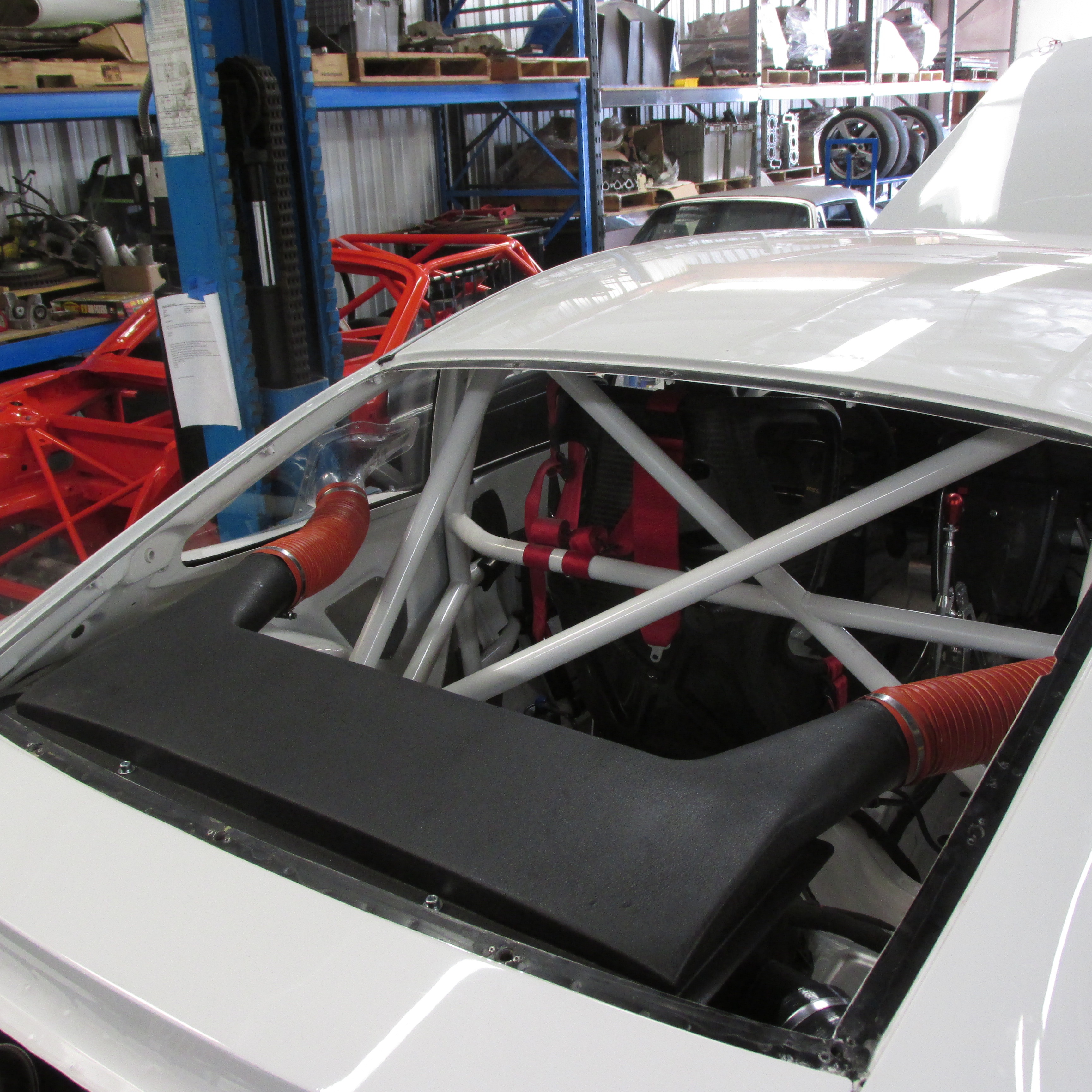

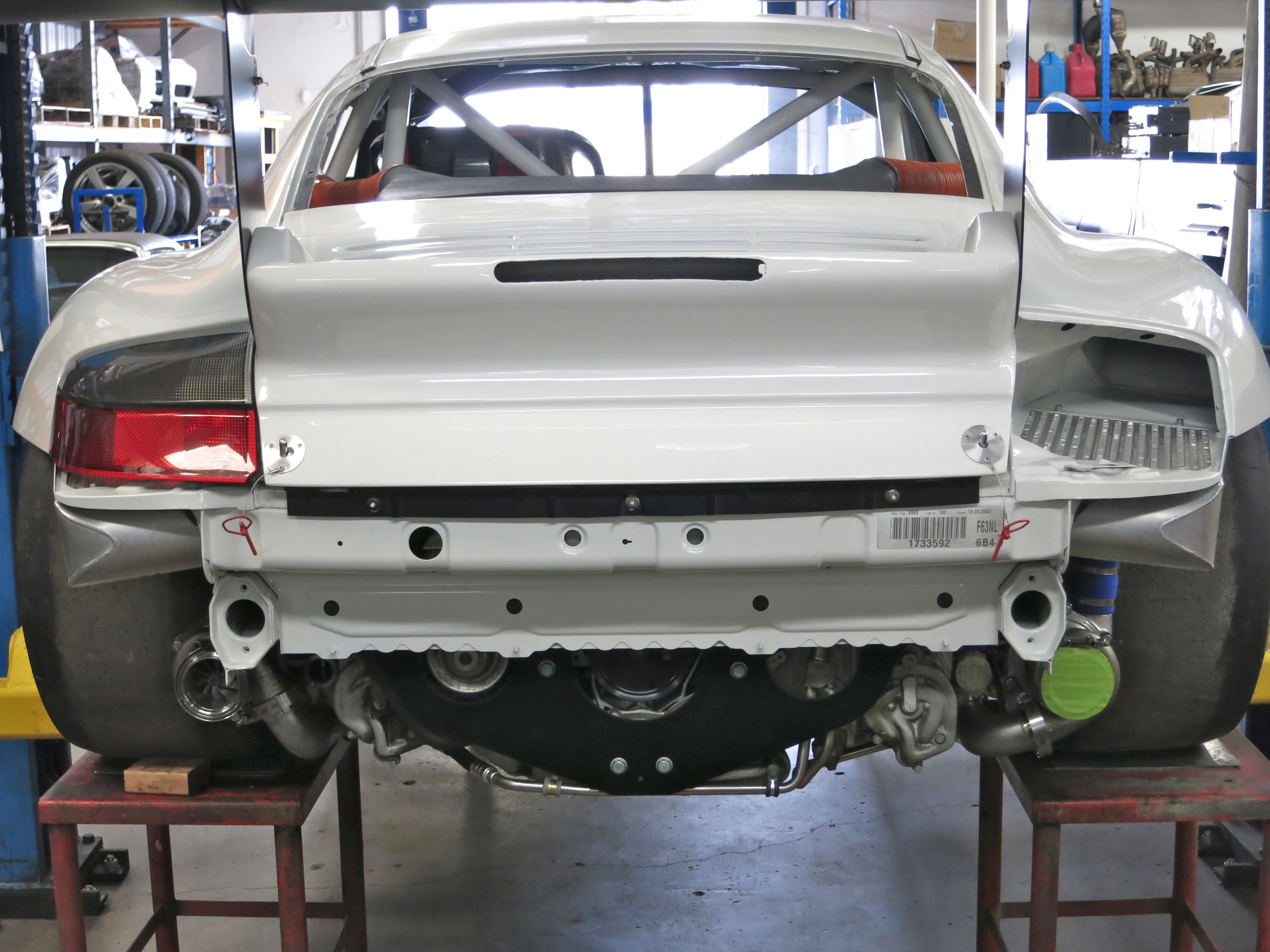

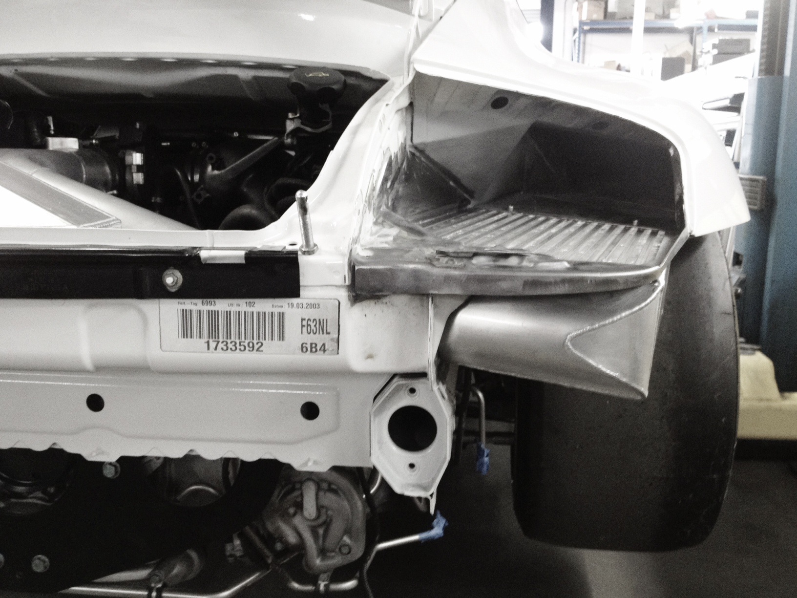

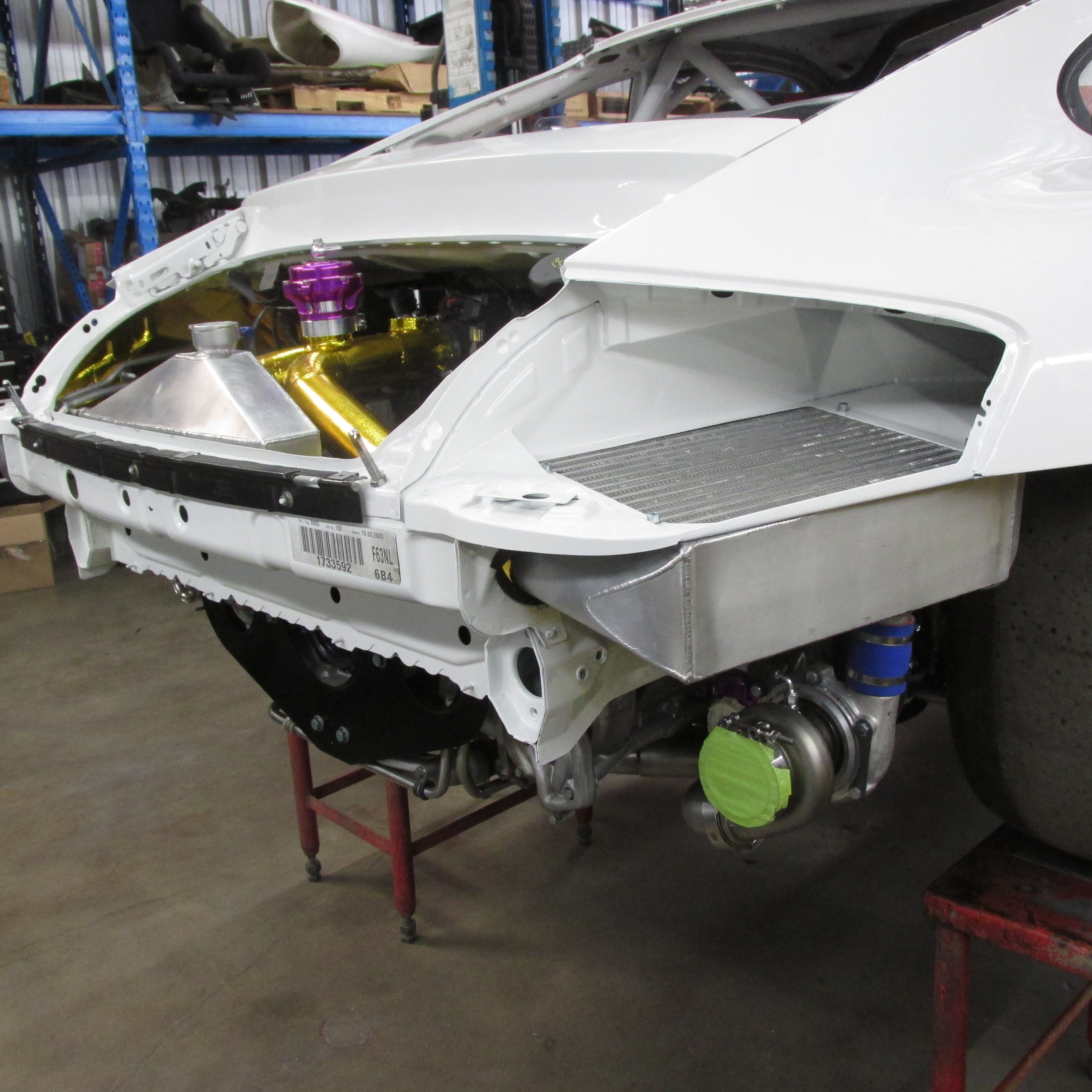

Might as well throw my .02 into the mix
Hardly feasible on a street car, but this is a dedicated purpose built race GT2. We had to relocate the headers, turbos, and intercoolers. Tub the rear to make room for the full RSR wheel/tire sizes, uprights, subframe, etc. We knew we needed bigger IC's but there's not a whole lot of room back there. Our solution was to channel the IC air flow with much larger surface area ducts just in front of the rear wheels (kind of like on the new 918). The air channel is massive leading back to the IC's. The intake is indeed in an extreme high pressure zone. The stock tail lights were gutted and now form the cover with simple push pin locks to allow easy access to the tops of the IC's to keep them clean from tire clag which is always an issue. We wired in simple LED lights into the tail light shells to provide legal (race sanction) brake lights. Then of course we had to plumb a new path to get fresh (and cold) air into the turbos themselves. We constructed an air box that holds two drop in KN filters ducted to the rear quarter windows (NACA ducts). Easy access for the filters too since our back glass (lexan) is held in place with quarter turn locks. Not saying this is better, or worse or whatever, just the solutions we are incorporating into our GT2 race car build. Cheers, John

Left out one point…
The low pressure side (under the IC's) is in fact what draws the air through the IC's. Underneath the IC's will remain open to enhance this negative pressure zone.
