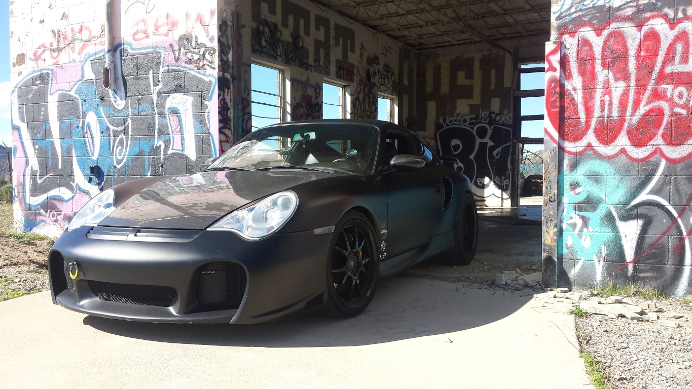

Originally Posted by ysfg35
Perfect , so rechart front bumper help to downforce ??? Perfect can u send me a pic for the bumper if u have please
Here you go.
Not sure if the front bumper makes a huge difference with down force, but it works on a car almost double the power your planing on using. I do have an OS Giken LSD and my suspension is fully built(coil overs, control arms, dog bone, drop links, sway, strut, etc). I would recommend lowering the front end from factory setting for sure. Just my 2 cents.

Old Feb 16, 2015 | 02:02 PM
'02996ttx50's Avatar
Joined: May 2009
Posts: 7,984
From: la
Rep Power: 608
that is an extremely non nonsensical looking car. all that and 3.8? nice.
