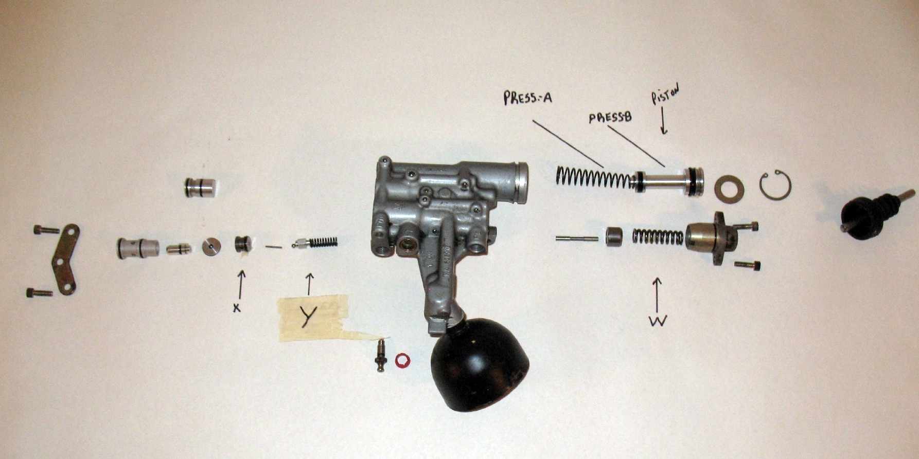

The slave is the first snag I had with my car. Migration was the problem. I completely dismantle the unit to try to found the failure. I did not found any worn seal or damage cylinder but there are two relief valves and a piston with two pressure applied. One with a small area (A on the picture) and one with a larger area (B on the picture). I cannot say I have found the exact weakness of this unit but the migration happen within this unit due to a faulty relief valve or a leaking seal in the piston area ???
Name:	Screen Shot 2015-03-25 at 19.22.20.jpeg

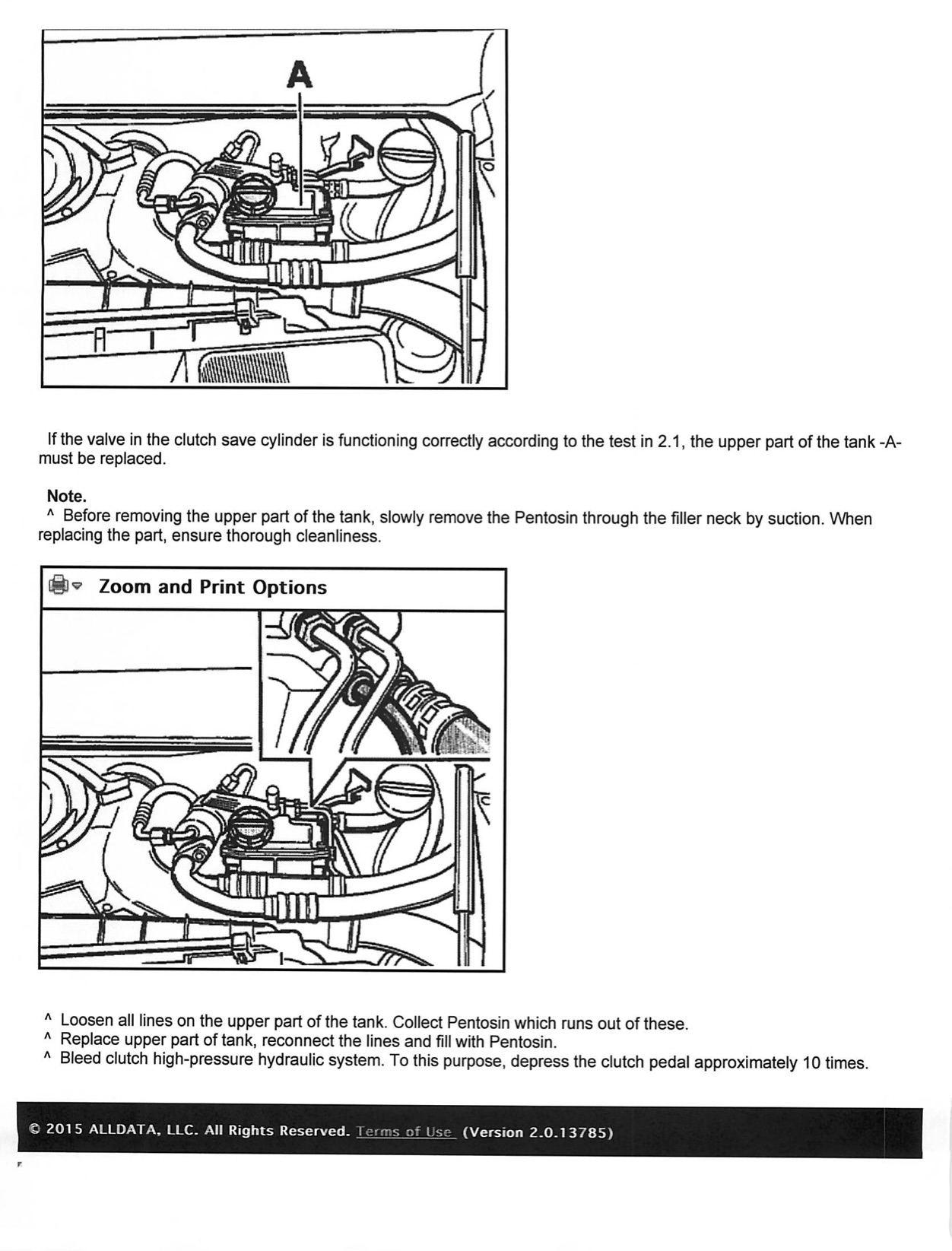

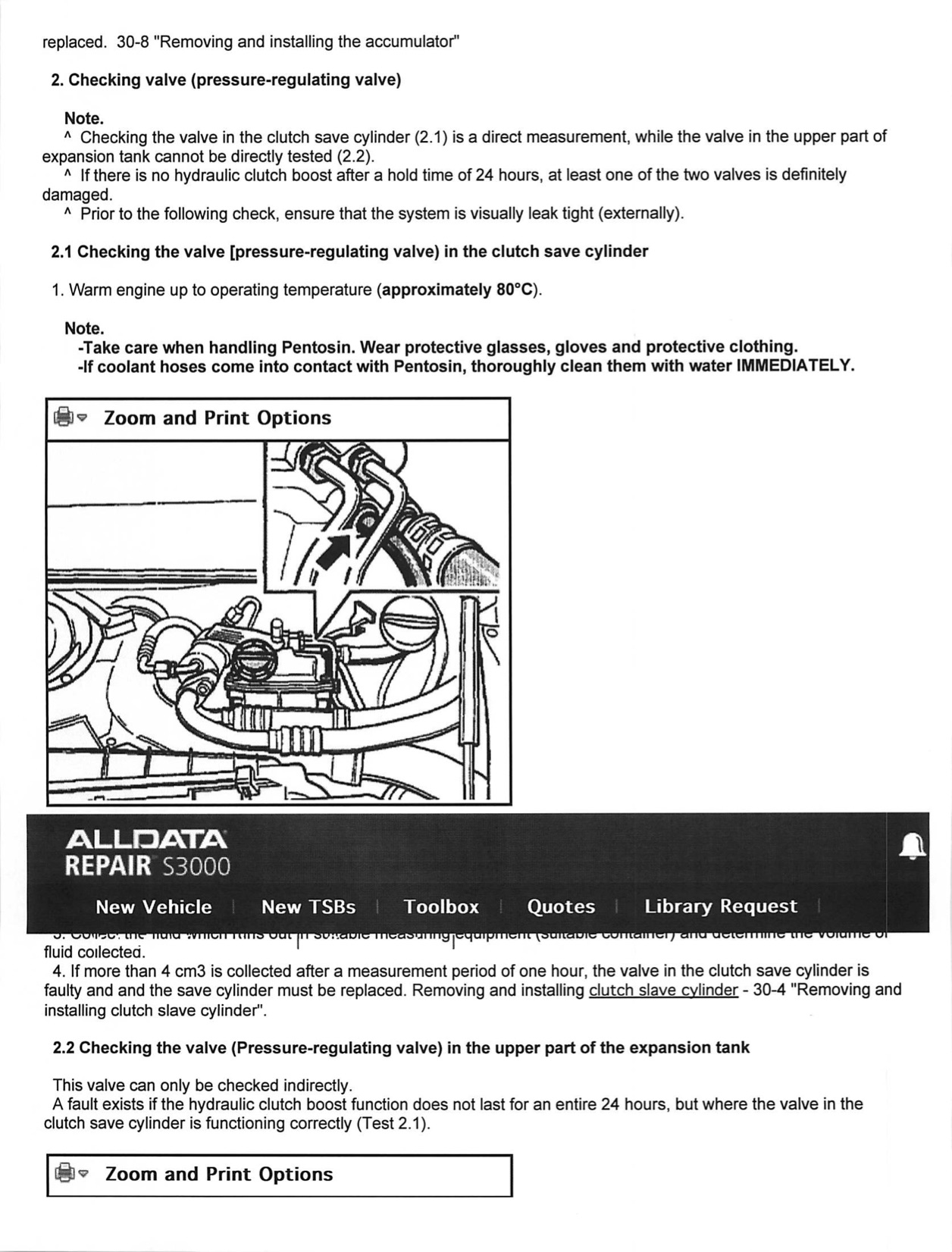

I'm not sure either. I'm an electrical engineer and attorney (insert jokes below), so I'm good at reading diagrams and understanding systems. However, I haven't been able to find a diagram of the clutch / PS system, so I'm kind of floundering.
I did go onto All Data. Interestingly, they recommend replacing the tank as a last resort.
I would imagine the slave has some kind of step down, but not a limiter... so wouldn't a high(er) pressure input also give higher out?
