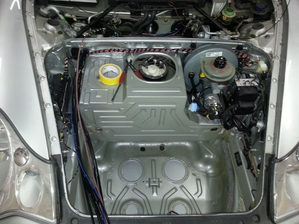

The tare down of the interior.

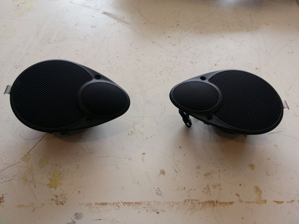

Next, time to modify the door enclosures and the dash speaker pods.
OEM Bose speakers
Bose mid range and tweeter removed. Then most of the plastic was cut and trimmed to fit new adapter ring.
The enclosures Bose speakers ere removed, cut and trimmed for new trim bezel to be attached.

The dash pods
Old Apr 5, 2015 | 10:08 AM
audioman79's Avatar
Joined: Nov 2014
Posts: 91
From: MD
Rep Power: 15
audioman79 is infamous around these parts
body filler added, smoothed and sanded.
test fit
Old Apr 5, 2015 | 10:14 AM
audioman79's Avatar
Joined: Nov 2014
Posts: 91
From: MD
Rep Power: 15
wrapped in black vinyl
OEM look and finish
