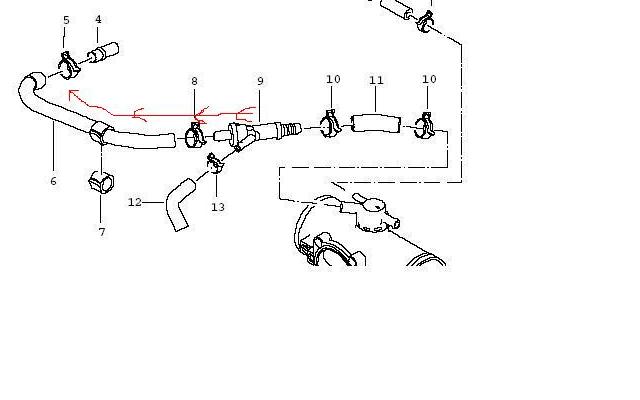

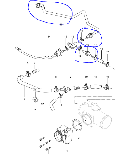

if as part of your boost leak testing you didn't check the intake check valves, they often can affect - boost and yet go undetected. they are replaceable, cheap items, and are often overlooked as the source of minor leaks, to the consternation of the owner of the leak. this i know.
just a thought, assuming you isolated all the other usual suspected sources of leaks.

https://www.6speedonline.com/forums/...6&d=1423832022
https://www.6speedonline.com/forums/...5&d=1423865543
996-110-135-70 is the one to the left of the plenum. the top one i cant find the part number. any porsch parts place or many here can/could help further. but hope this helps somewhat.
