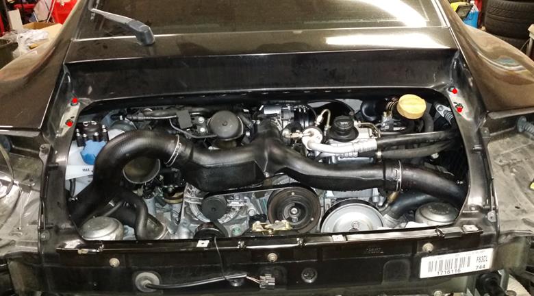

5. Remove the rear deck lid. It can be easily removed by unplugging the electrical connector on the passenger side, and unbolting the 4 bolts holding the hinge. You’ll want a helper for this so that when you unbolt one side you can easily control the deck lid without damaging it or your paint.

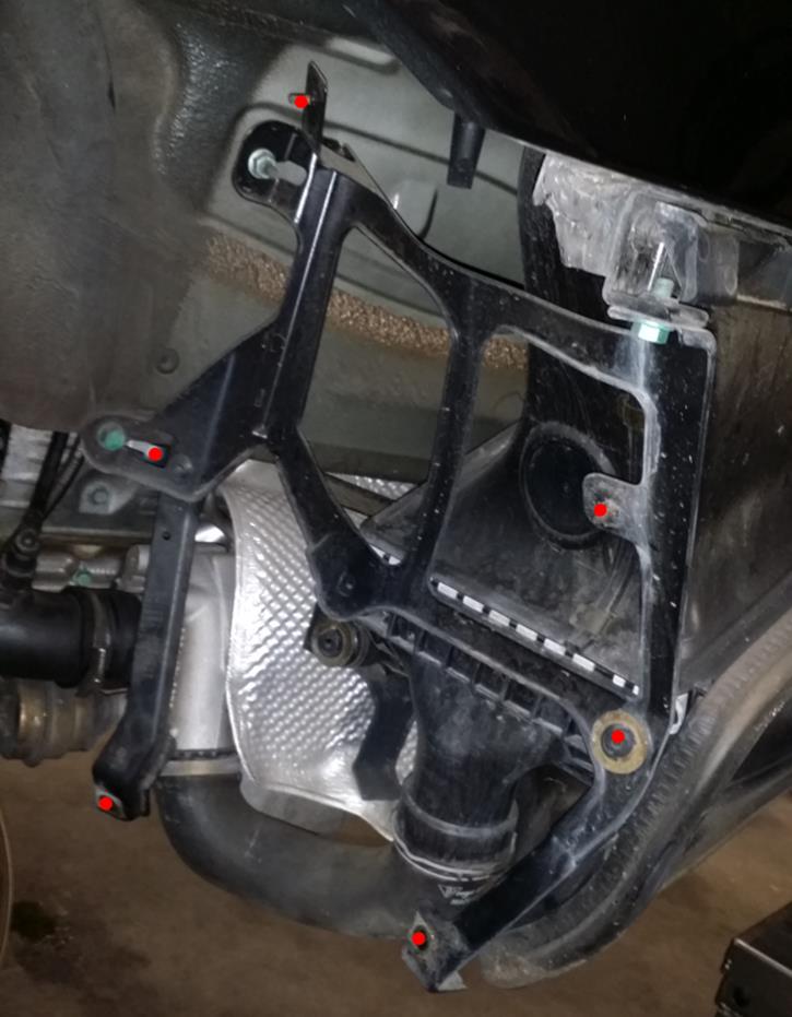

7. Remove the “rear” rear fender liner. You’ll need to remove it for access, and also to get the rear bumper off. It’s held on by a lot of screws.

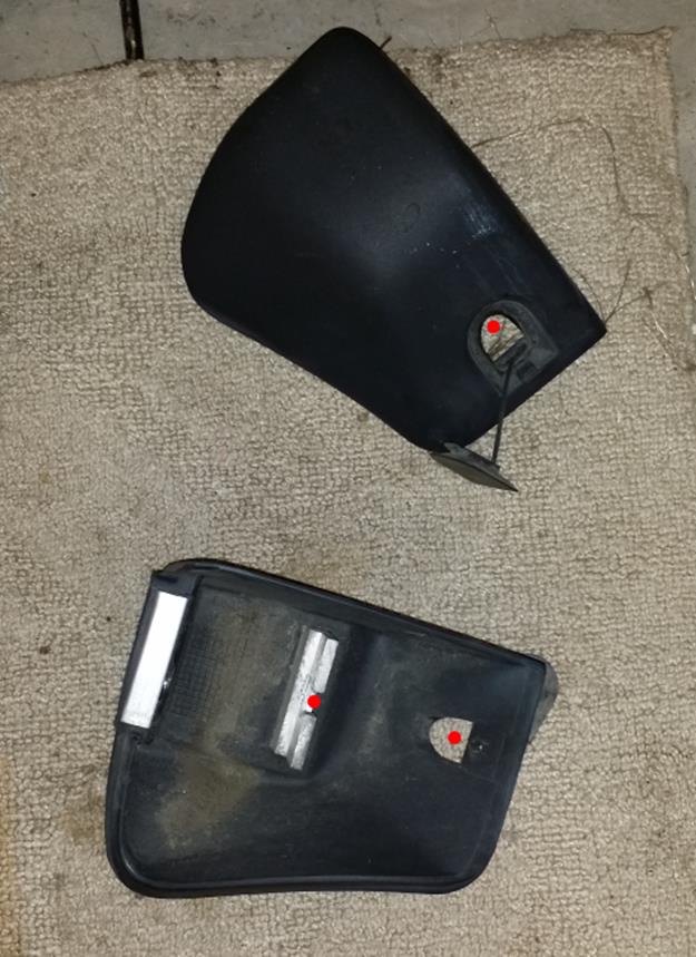

8. Remove the tail lights. This step is kind of optional I believe, but it was stupid simple to do, and made for a good place to sit tools for me. The tail lights are held in by two screws around the bottom right and left of the engine opening. The tail lights should just come out with ease after they are removed. Make sure you sit them some place that won’t get them broken.

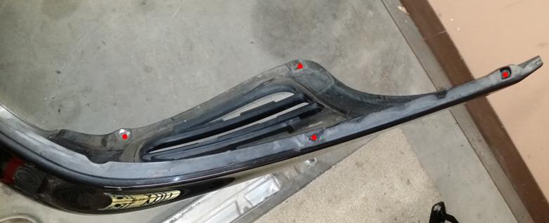

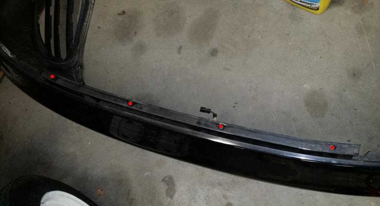

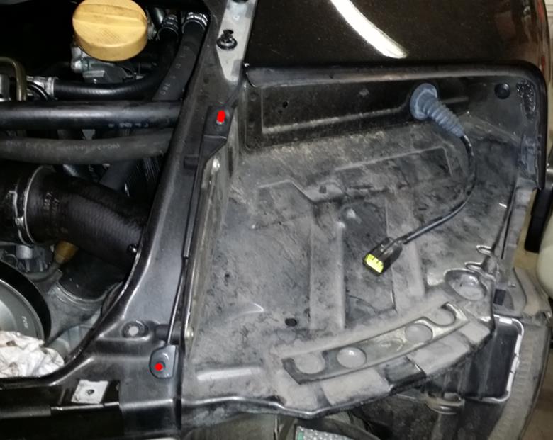

9. Remove the rear bumper. Remove the license plate frame, and any rear bumperettes you have. I had the two near the rear license plate frame. They were held in by one bolt each.
Once that’s out of the way, the rear bumper is held on by 4 bolts in the top middle of it, and on each side, one in the top at the edge (near the rear wheel) and two on the bottom edge (also near the rear wheel)
Vertical view of the side of the bumper. The far is the bottom, the close is the top

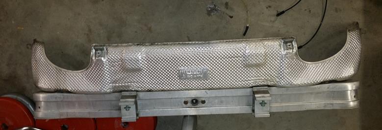

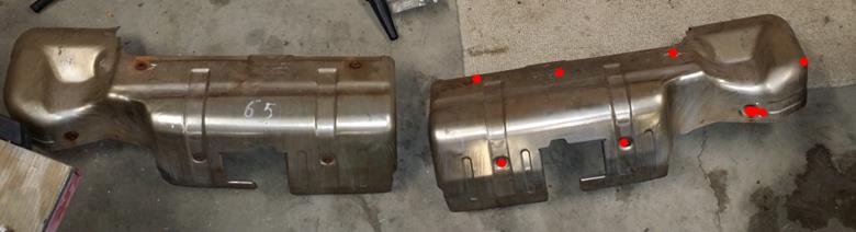

10. Remove the exhaust. This is held in by being bolted to the turbos and some weird strap mechanism that seems kind of overly complicated considering it results in a solid mount. (Why not just use some bolts to solid mount it Porsche, come on) You'll want to unbolt the exhaust from the turbos first. There are 4 nuts on each turbo. The exhaust won’t fall don’t worry. After that, onto the straps. To get to the straps you'll need to remove the heat shields. Take care to break as few heat shield bolts as you can. If you are in no rush, some PB blaster on them and take a break here is a good plan. If not… be really careful, they break easy and are probably corroded on there. Once the heat shield is off you'll see the straps on each side. Unbolt these and slide the straps to the outside of the car. Eventually it'll come off the big metal tabs and the exhaust will fall into your lap. Take care, it’s rather bulky and heavy for what it is.
The heat shields you’ll be taking off

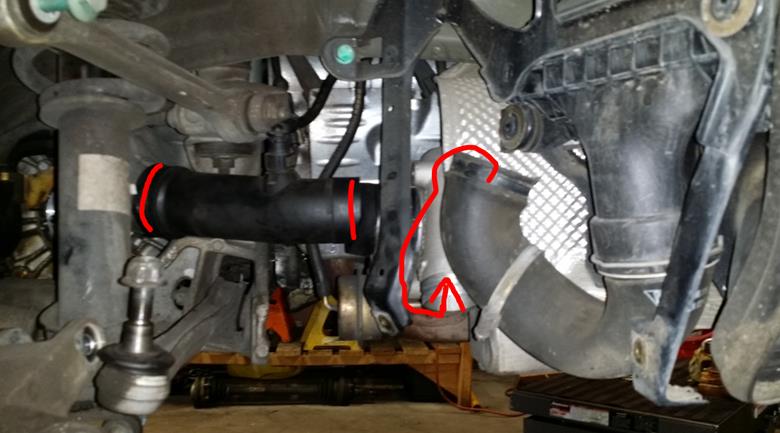

11. Time to remove the hoses connecting the turbos to the intake plumbing. Since you’ve removed the rear “rear fender” cover, you have access via the wheel well. You have the turbo compressor outlet going into the intercooler, and you have the intake piping to remove. All in all, only 3 clamps on each side then pull the pipe off.
