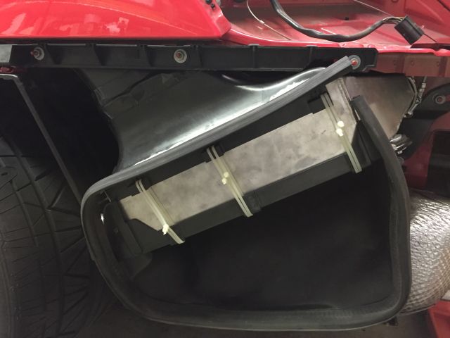

The next weekend I pulled off the rear bumper and started to install the SRM 4.5 intercoolers. When I opened the box it was immediately evident that Sean at SRM takes a great deal of pride in making a perfect product. The intercoolers belong in a glass case, not hidden behind a bumper. In the process of installing the intercoolers I ran into a bit of an issue and called Sam...at 6pm...on Saturday...on Halloween night...and he answered. He talked to me for a while and decided my problem needed input from Sean. He told me to sit tight, and within 20 minutes I'm on the phone with Sean! Sean took time from his schedule to explain to me where I was making a mistake and talked me through the proper procedure. Simply amazing customer service. (BLKMGK was also there to lend a hand over PM, huge thanks to him as well!)

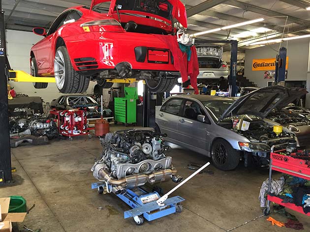

Two weeks later I took the car to ESTuned to get the clutch installed. Shop owner Evan Smith and head mechanic Rick Warner were great. In two days they had the motor out of the car, clutch, injectors, and turbos installed, coolant lines pinned, and motor back in the car. Upon starting the car it had a dead hole. I immediately call Sam...at 9pm...Sunday night...he answers! He gives me a few things to look for and when all checked out I pointed at the tune. He immediately sent me a tune from another customers car so I could verify it was the tune. He stayed up and answered the phone every time until it was fixed, which happened at midnight. It turned out to be a bad EV1/EV14 injector adapter. Rick replaces the adapter, I upload the original tune and the car fires up and runs great. I drove it 30 miles home and it never skipped a beat. Sam insisted I message him, regardless of time, once I made it home safe. I've been doing the car thing for a long time and never in my life have I experienced the kind of service that Sam insists on giving. The a1668 turbos and the catless Kline exhaust sound amazing. It's not nearly as loud as I thought it would be. Its got a deep tone that sounds like a factory race car...with hardly any drone at cruising speed. From start to finish Sam has been there 100% of the time and his advice has been spot on.

Zip ties are killing me man! ;-) Thise straps are a real PITA to drill, killed a couple of bits.
Yeah, I got a bit lazy.
