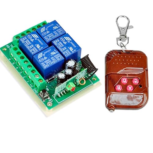

I was thinking of putting another set of AMG paddle shifts on my Ford F150 EcoBoost which doesn't already have steering wheel mounted shift control, and was looking at using a small off-the-shelf RF transmitter to act as a "wireless clock-spring"...
Search for "2ch wireless remote" and you'll find hundreds of them for just a few bucks on ebay and amazon. Hack the paddles (or tip switches) into the remote portion and place inside the steering wheel, put the receiver under the dash someplace. Downside is having to pop out the airbag every year or two to replace the transmitter battery...
