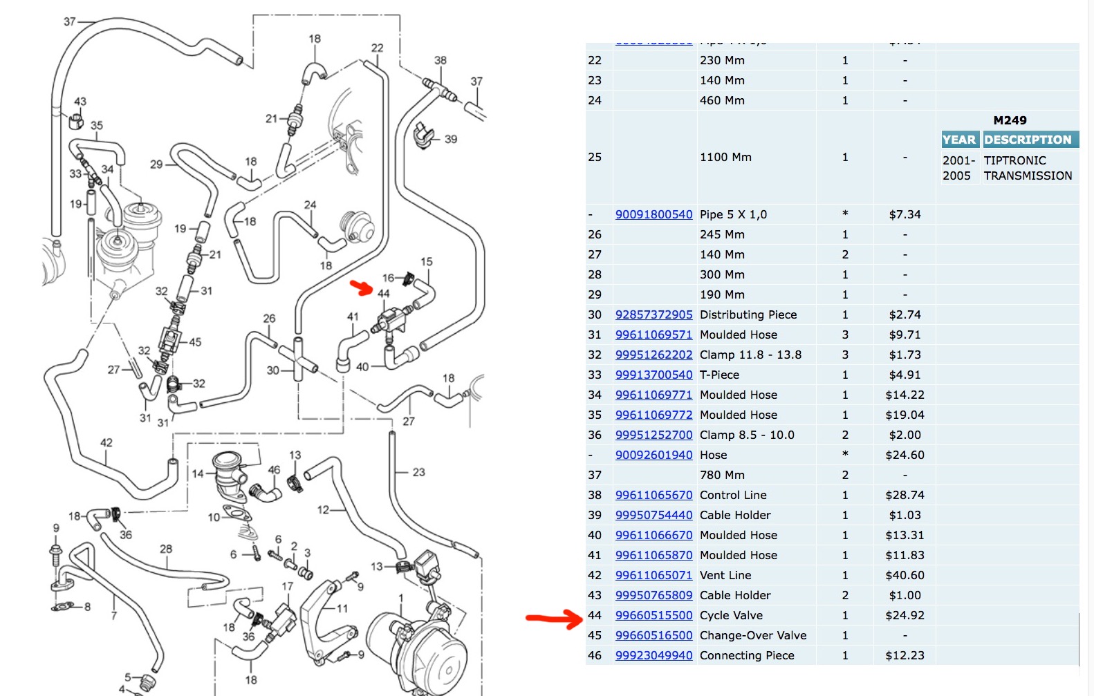

99660516500 is a change over valve and it is related to the EGR system, item #45 on the picture. The N75 called a cycle valve is #44 which control boost.

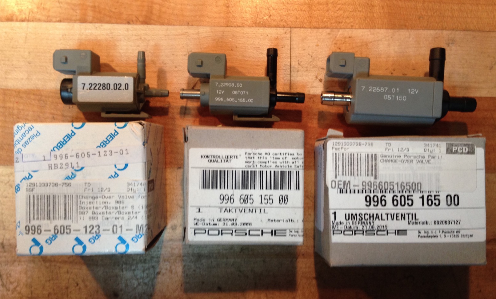

Dont be frustrated, you will always found someone to help you here ;-) I took a picture (sorry for the phone pic) of the three valves side by side to show you the difference #17 996-605-123-01 (7PP906270) (the one you order) #44 (N75) 996-605-155-01 and #45 996-605-165-00. Yes I have all three in stock just in case That's me

155.00 is correct. jeanmarcs pelican link is correct.
its also visible with the engine decklid raised. if it doesn't say "bosch"? dont buy it.
i sure hope jp's valves say bosch as he is never wrong lol

the n75 valve is the only CLEARLY visible bosch valve you will see at the lower end of your intake area. NOT the MAF which will not have the "bosch" lettering visible, plus the maf is on the "drivers side" of the engine comp from the N75 on lower right ( passenger side moreso ). sorry i dont have a pic. just look for the "bosch" valve it'll be staring back at you.
