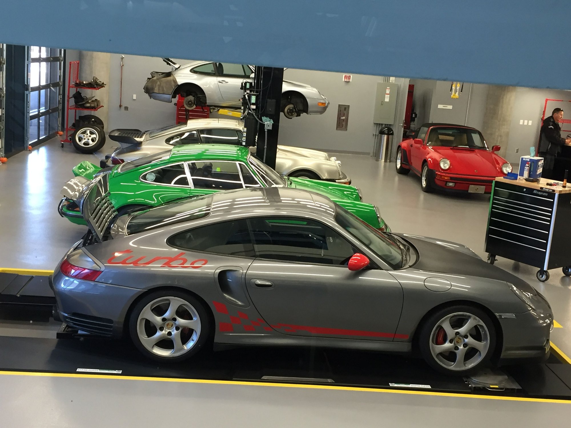

2 weeks until Road Atlanta DE.
Got the Cobb AccessPort from Sam and excitedly hooked it up to my car. Nothing!?! Cannot see my ECU! Phone calls and texts with Sam and he's on the phone with Cobb and I'm tearing into the car looking for the ECU to see if it had been hard chipped or had some sort of inline tampering. Nope. So I take out the ECU and send to Cobb. Turns out the previous flash had locked us out by deleting the ECU ID. Joe at Cobb says PIWIS tool is needed to reflash back to stock. Cobb sends back my ECU and I head to Porsche. I show Joe's email to Kellan at Porsche Classic Center and he knows just what to do. They reflash the ECU with the latest software for 2003 X50 with K24's.
Night before Road Atlanta DE.
I reinstall ECU and Sam walks me through the Cobb AccessPort installation. It works and it comes with several pre-installed MAP's. Sam says he will send me the MAFless MAP's that evening. I get the new MAP's from Sam late that evening and download them to the AccessPort.
7:30 am Saturday, Road Atlanta about to go through tech.
I install the MAFless tune that Sam sent me the night before. It loads with no issues. Drive around the parking lot and everything seems to be working fine. The PSM and ABS fail warnings do not light up. No MAF codes.
9:00 am Saturday, Road Atlanta, Lap 3
PSM and ABS fail lights come on. Head into pits. Turn off car and restart. Lights are extinguished. Go back out. Car runs perfectly the rest of the weekend. No codes. No warning lights. See 1.2 bar for the first time ever!
So that is my first two days with the Cobb MAFless tune. Pretty hectic, but so far it is performing as promised. I will update with more observations as I use the car on the street. Thanks to Sam for all the support!
