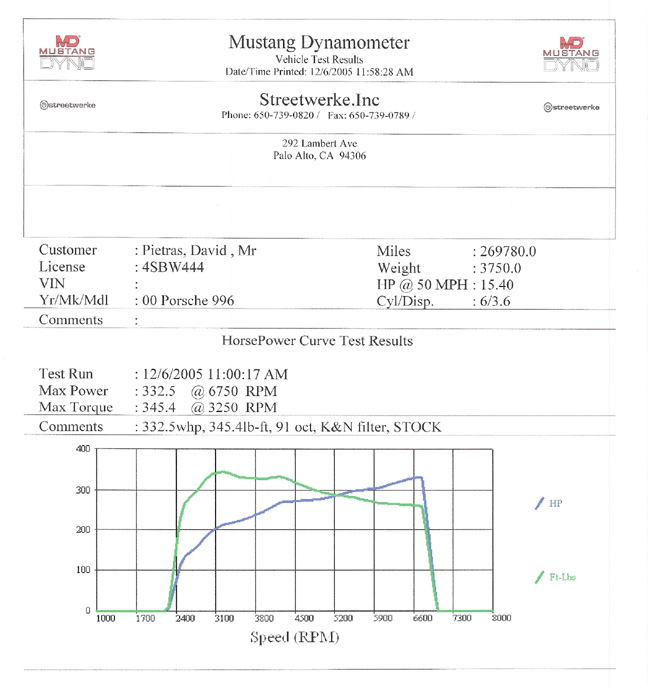

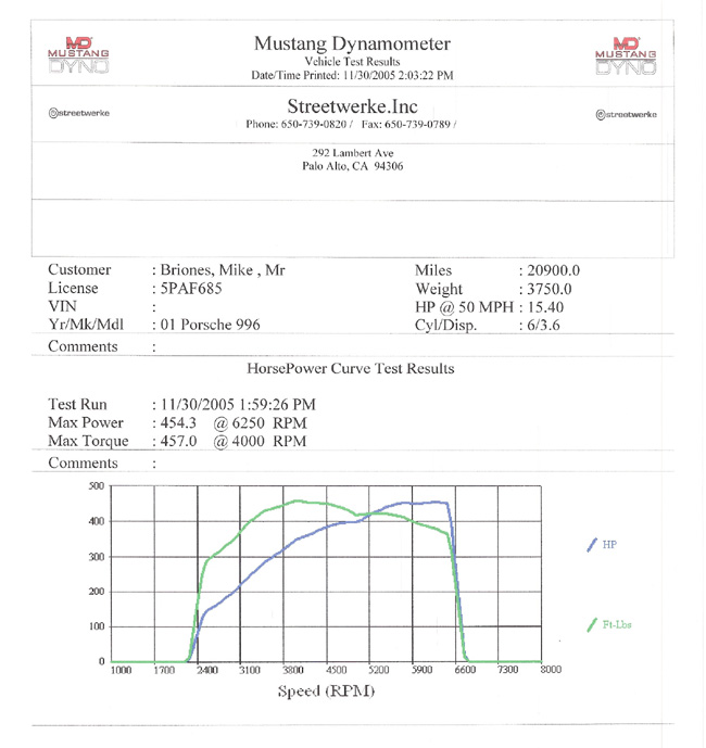

We ran a coulple of cars on an independent dyno,
Same conditions, same test procedure on a Mustang AWD dyno.
PSI 550 car and a stock car for comparison, both on 91 octane.
Old Dec 7, 2005 | 04:38 PM
Speedaddy's Avatar
Joined: Aug 2005
Posts: 7
From: NorCal
Speedaddy is infamous around these parts
Stock car
stock car

The boost frequency valve is all over the place. Was it hitting knock control? Looks like it from the dyno. What gear were the runs made in. Timed or sweep?

We are looking at a Mustang, not a DynoDynamics. Two totally different dynos. Bottom line is the comparison being made here is on a Mustang. We know what they read. I know just a little about them. You need to compare apples to apples.
As far as being calibrated. All Mustangs are done so before they leave the factory. If they print screen the parasitic page I can tell you if it is in the ballpark.
Regardless of the numbers that run has something wrong. The chart is all over the map. If I had to make a guess I would say the frequency valve is closed for too long then is overshooting to compensate for the overshoot.. Hence the hump then the dip and the hump and dip again. This is the valve modulating when it is requested to do something beyond its limit. You could scope the valve if you have a 200Mhz scope and compare that to the RPM signal and see what it is doing. It should produce a square wave to the falling edge of the RPM. You can count the pulse widths or cycles that it is moving

They are ok, the concern is the curve. Something is not right with the car.
Based on the dyno curves posted, I really don't understand how you can immediately determine such things. Only datalogs/test measurement can tell what engine parameters and actuator conditions are.
All Power Curve pulls were done in 4th gear using the Vehicle Simulation mode with simulated inertia enabled (not a controlled sweep or manual load pull). Parasitic value is 1.00 on our dyno. The rpm window method was used to capture the data. We also have all of the trace data on file (A/F ratio, boost, etc.) for internal use, but it's not my position to offer that data to the public. I believe the SAE correction factor ranged from .998-1.004 during the PSI550 pulls. Peak uncorrected power on the PSI550 was actually 463awhp on a couple runs.
I think people should take note of the fact that California 91 octane was used. This is very important. The actual octane performance of that fuel is very close to east coast 89 octane. If the PSI550 car was dynoed on east coast 93/94 fuel, I'm sure the power curve would be higher for sure. Considering the cars that we've seen on our dyno, I was impressed with the PSI550 numbers.

How could I know...Honestly, because I have over 500 runs with TTs on the dyno. I steady state tune on average 5 cars a month just from the motor builds we do then anything else that walks in the door. I have been through the years of development with the TT since the beginning and know its behavior. I can tell a lot by a chart. I have flown all over the country to work on TTs and tune them properly. It is not that hard truly after hundreds of TT tuned. Only two conditions can exist to cause that dip. We only have 91 here in KC and tune cars for CA on 91 as well. So I am well aware of what the octane can do. On a curve like that something is incorrect. If one really wants to know what the valve is doing. Like I said scope it. I would be willing to bet that it is all over the place. I use a Tectronix 2012 for scoping. It would work fine in this application as well.
All your dyno parameters are on spot. We have the same PV. SAE corrected value of 1.005. Again, the numbers wee fine, the curve was not.

Realistically, I think that specific PSI550 car needs to be tested again. I'd like to spend more time on the car, since the first time around I didn't really get too involved with the "why" behind the dyno curve. Clearly that dip needs to be addressed, "if" it's a reoccurring issue. Overall, the results seemed promising to me. I've seen a lot of TTs come through here, and it's always nice to see a car make the claimed power like that PSI550 car did. In fact, I looked at the MAHA dyno runs as provided by PSI and the wheel hp is spot on with our Mustang. That alone was refreshing.
