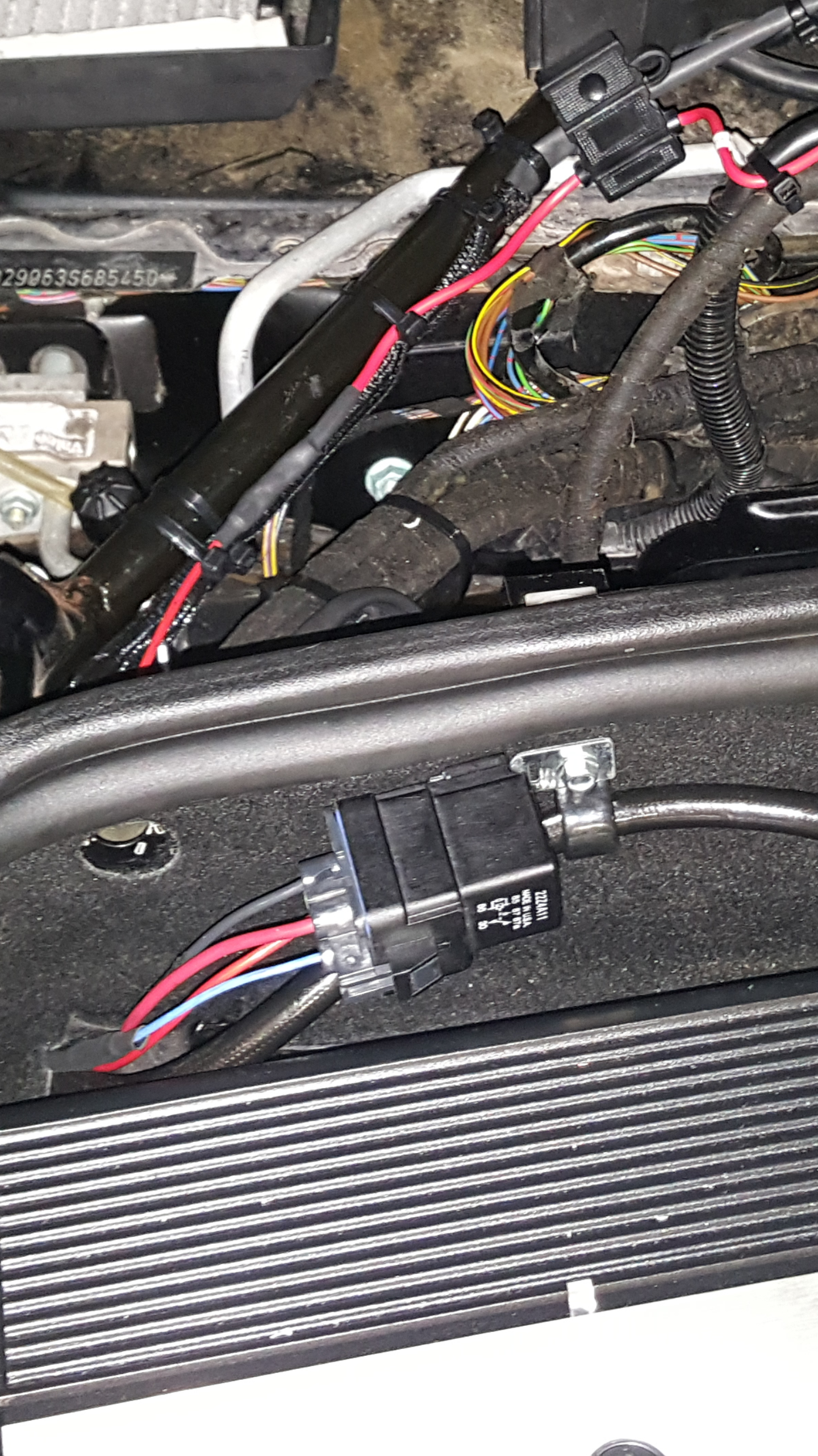

I had wiring issues with the srm fuel pump too. Two fried wires from the relay.

Without sounding like an a$$whole How did the wires short out ?
Wires from relay dont make contact well and move around. We cut all the wires and took out the relay connector. So far its been working great.

Interesting I'll have to look at mine. I have only one relay I don't use the stock harness to power anything but the fuel level sensor and I reworked the way it was installed originally. I just didn't like the way it was installed. I'm an electrical contractor by trade so I was curious to know how it shorted.
Wire was burnt 6inches. You take the relay connector out of the black plastic and connect the ends right to the relay.

Here's how mine is installed. Powered right off the battery fused of course. I haven't had any issues so far.
