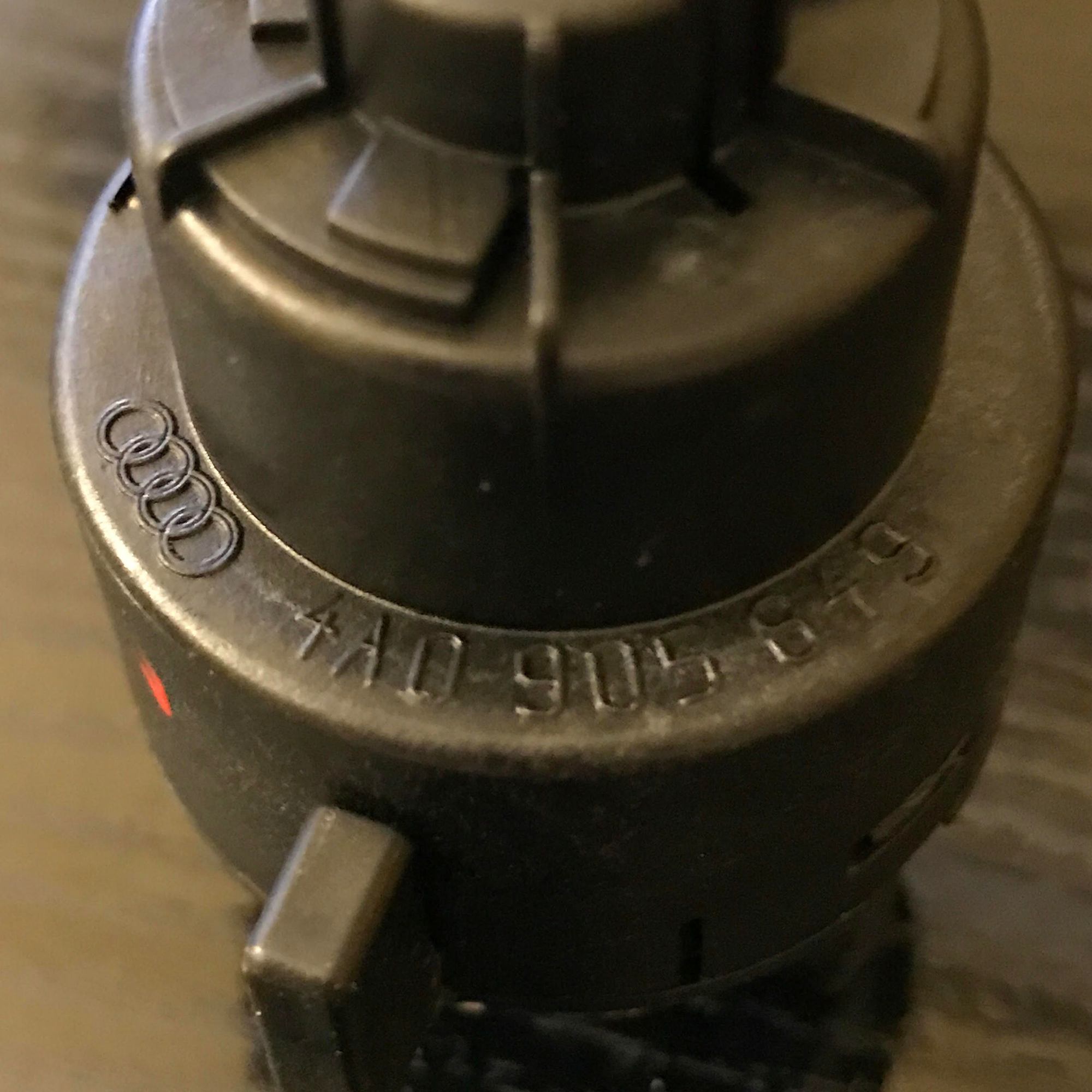

4B0905849 doesn't seem to fit a 2003TT. Any ideas?
Originally Posted by DSCOFF
So I just went through a momentary, semi-heartstopping moment this past weekend. I've had my car back after the big build for just over a week, Sunday I decided to join a few friends at Cars & Caffe in Bergen County.
Everything was fine, we did some spirited driving leaving the meet to go check out a local AutoX. When its time to go home, I put the key in, turn it, and.....nothing. No start, no click. Just lights on the dash and I can faintly hear what I presume to be the fuel pump priming.
I noticed I left my radar plugged in, so my first guess was dead battery. I tried a jump, still nothing. Then as a last resort to avoid a tow, we tried push starting and the car fired right up.
The culprit, a bad ignition switch! If you go to Porsche they will advise you that you need the full ignition mechanism and have you spending $600+. The good news is that the ignition switch itself is a part shared by VW/Audi and can be had for ~$10 on Amazon Prime. (Or ~$50 at the dealer if you need it same day). It take some finagling to get under the dash, but this is absolutely a repair anyone can do on their own (take that as if I can do you, you can do it )

Never mind - the part number is on top along with the Audi symbol
From what i can tell if the ignition assembly has never been swapped out, this is the correct part number here.

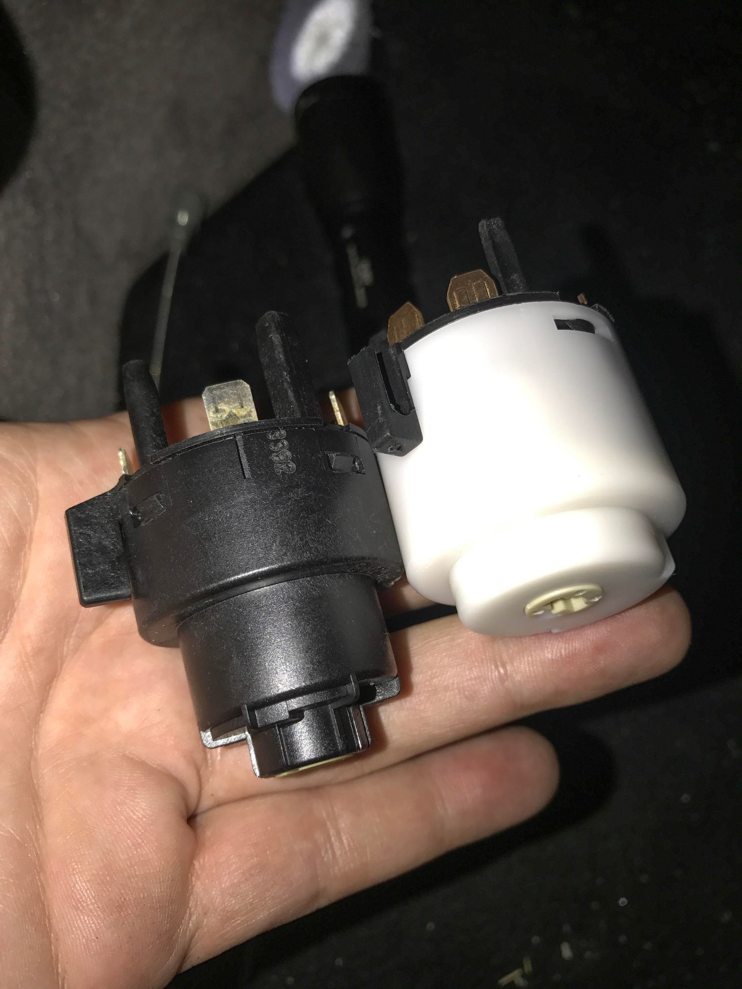

I just replaced mine and it was a piece of cake, other than getting stuck under the dash. $17 delivered from Vertex in Miami.
Pedros instructions (noted Above) were awesome.
I took the old one apart; it appears the dielectric grease dries up and turns to glue.
