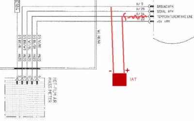

Correct is at the ypipe but controlled by the maf sensor on wire 2.

That is correct but heres the other wire for the iat.
the integration of a temp sensor inside the maf is used for the function of the maf himself...(not for IAT)
