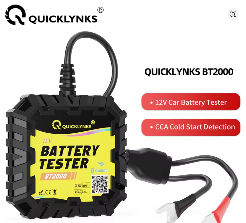

I don't mean to hijack your thread, but if you're going to be in the battery compartment, I highly recommend you also install a Battery Monitor/Tester.
Best $25 I ever put in my Rapide.
Every diagnostic test you can pull with a battery tester, and live State of Charge, and on-demand CCA measurement is available over Bluetooth straight your phone.
It also records every start/crank with 0.1s precision so you can see if the battery struggles over time.
Installation is just + and - hookup. That's it.
