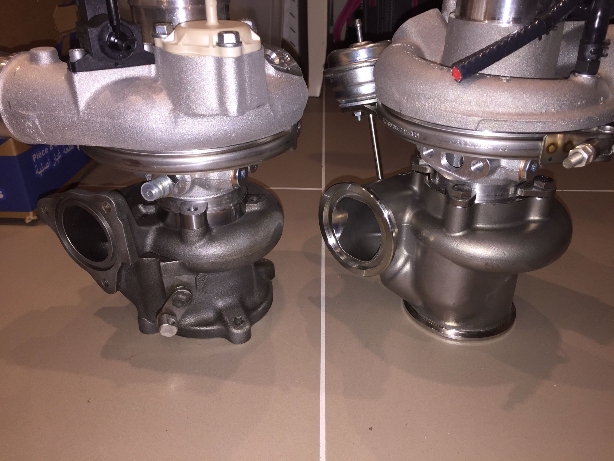

EFR turbos have arrived.
See pic below with BW v-band housing vs. SRM housing.
It is really nice with the plug n play nature of the SRM housings, but damn those v-band housings look well designed..
They are 0.85 A/R though vs 0.6 on the SRM housings.
For my 800whp goal, I think the SRM housings will do more than fine.

996tt550hp has a reputation beyond repute996tt550hp has a reputation beyond repute996tt550hp has a reputation beyond repute996tt550hp has a reputation beyond repute996tt550hp has a reputation beyond repute996tt550hp has a reputation beyond repute996tt550hp has a reputation beyond repute996tt550hp has a reputation beyond repute996tt550hp has a reputation beyond repute996tt550hp has a reputation beyond repute996tt550hp has a reputation beyond repute
The efr turbo is a k24 housing?

From: Cph
krikra has much to be proud ofkrikra has much to be proud ofkrikra has much to be proud ofkrikra has much to be proud ofkrikra has much to be proud ofkrikra has much to be proud ofkrikra has much to be proud ofkrikra has much to be proud of
No the EFR Turbo is available from Borg Warner with v-band or a couple of T3 flanged variants i think.
But SRM sells the EFR7163 eliminator kit incl a special K24 style turbine housing designed to make EFR plug n play. Nice.

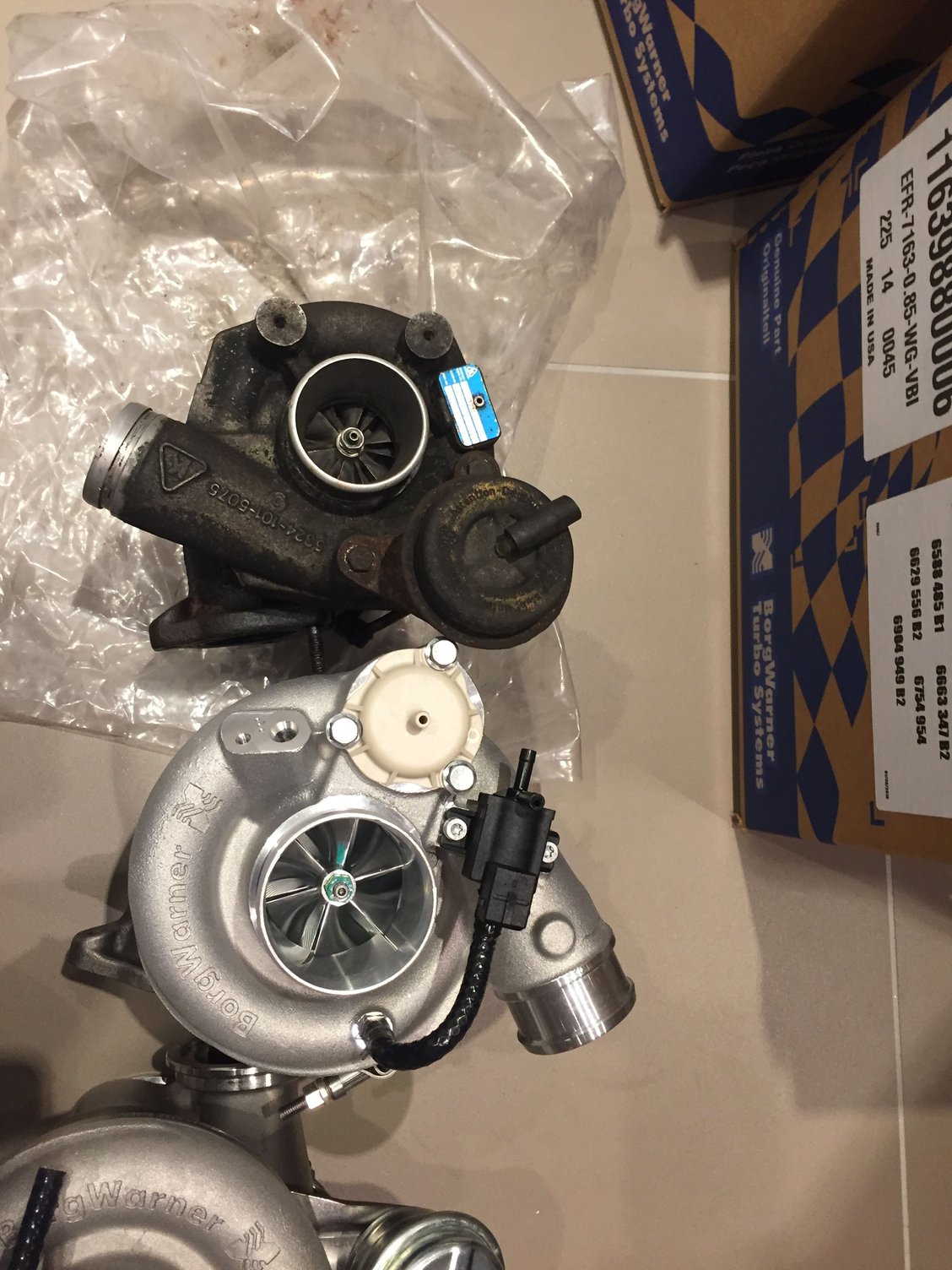

How EFR looks next to K16..
Unfortunately I no longer have my GTX3071 turbos, they sold.
Would have liked to compare.
