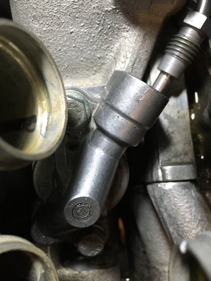

Leak fixed! What a pain. I had to remove both coolant lines off of water pump housing to gain access. The key is ensuring no debris including coolant stays out of your chain tensioner as you compress it before bolting in.
I had to loosen the drivers side oil feed line at the turbo and the support bracket in order to reconnect to chain tensioner cover. Do not push or lever off of chain tensioner cover as you seat this oil line! I think that's how it started leaking - ooops! The two 10mm bolts are only torqued to 8-10 lbs.

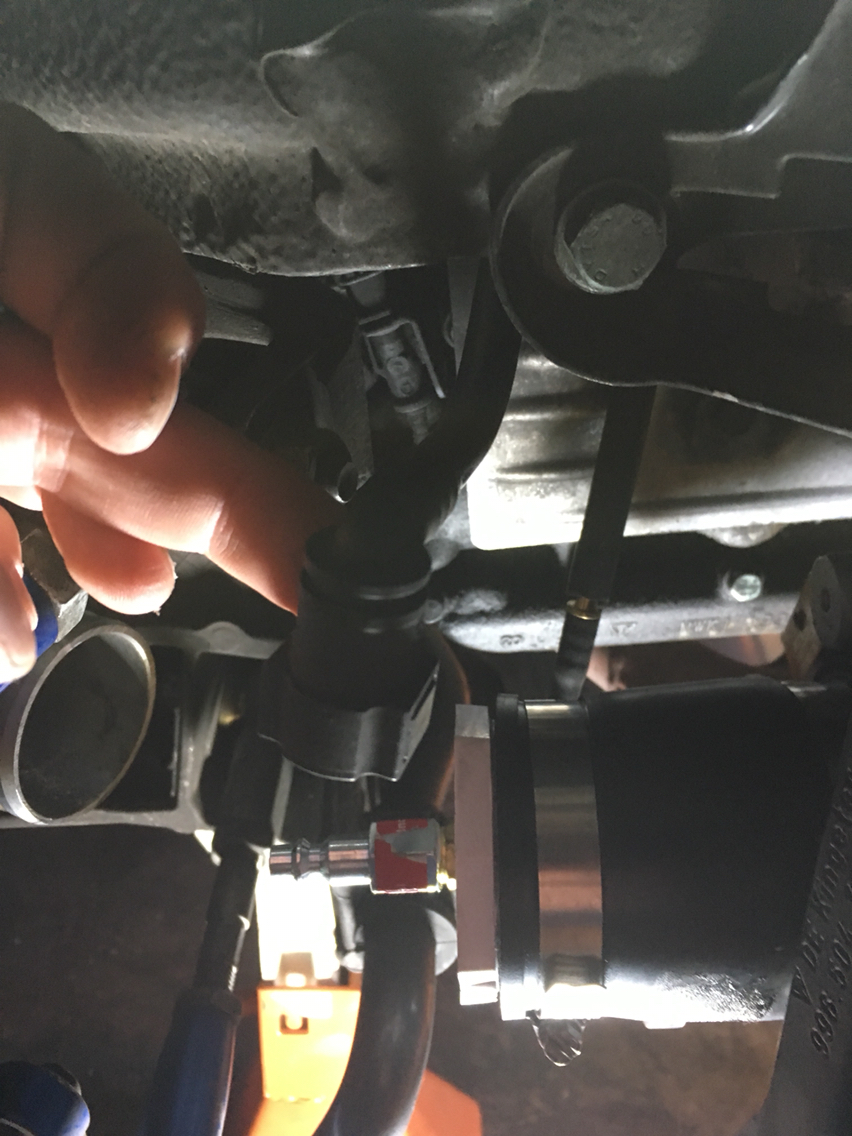

Well I did a boost leak test through turbo compressor inlets and have air rushing out of drivers side pre turbo line that goes up to check valve #16.
I have ordered and will keep checking as I fix them! Is there any benefit to testing from lower IC hoses instead? I followed Markski's protocol thus far. Thanks guys for your support!

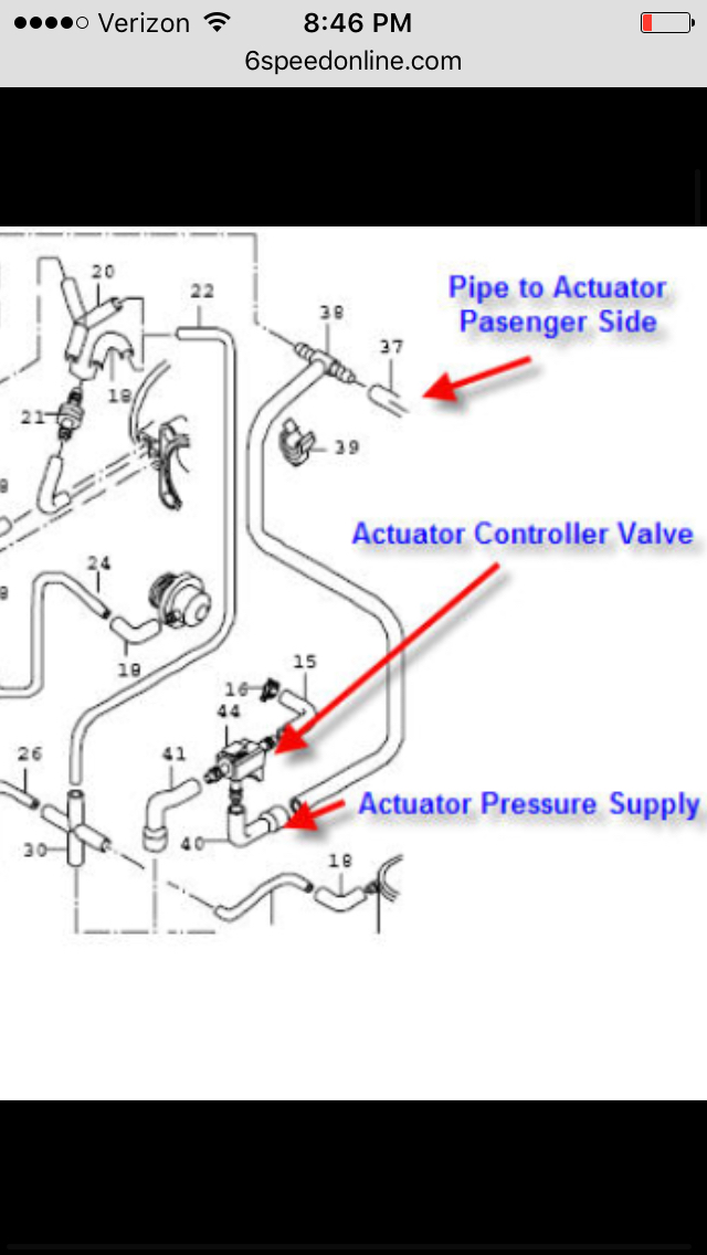

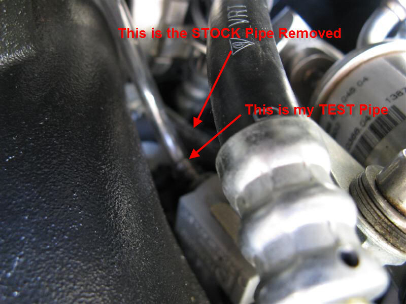

I let Sam know and he thinks we need to adjust the WGs a little. I saw a good diy on doing it through the control valve vacuum lines. I need clarification on exactly what line to tap in to. This pic was on the thread. Gonna use a Mighty vac.

Well your out of the woods bud! I would start with going to zero preload and then one turn past it. They are brand-new so I can tell you that's going to get you pretty darn close for now. At least we can see how it reacts to that. Who knows what the shop did. Yes you can test it with a mighty back but I'm willing to bet you Setting it at zero preload +1 mm or one full turn is going to measure out to about 13-14psi cracking pressure. I was on the dyno today but I can walk you through it tomorrow buddy.
