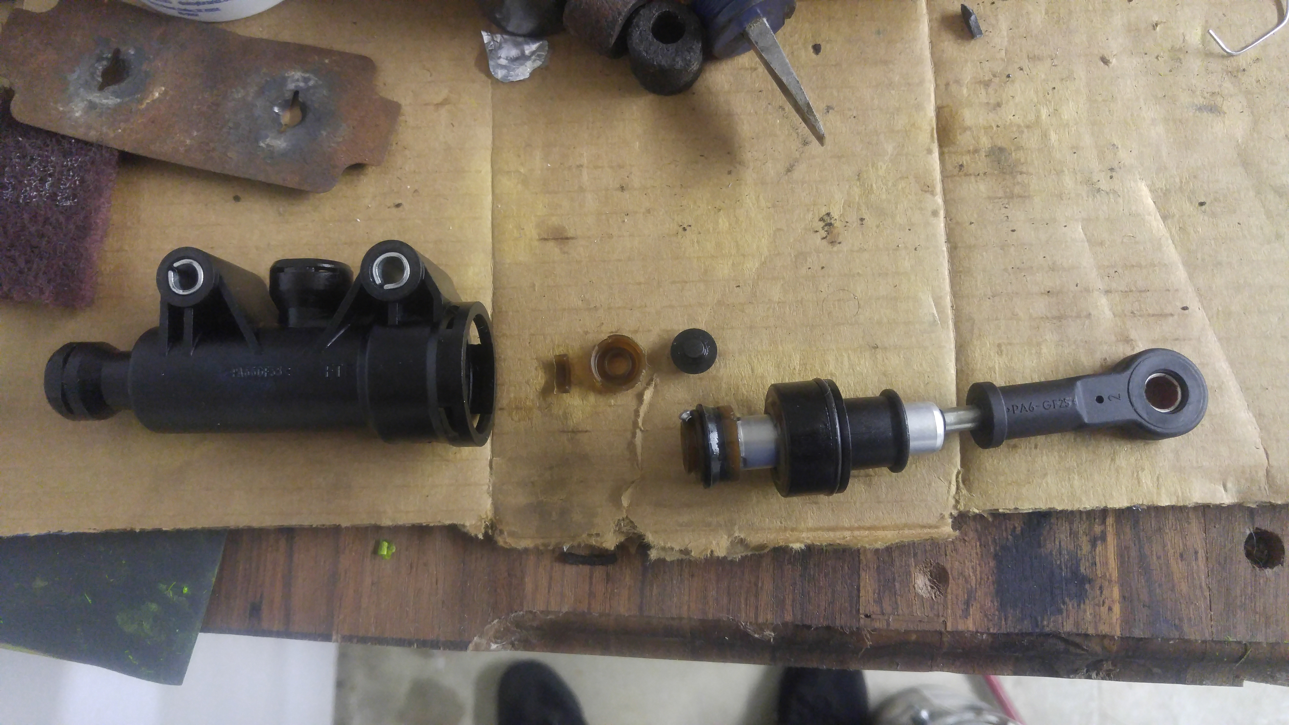

I finally got the 911 back on the road last night.
I took apart the original master last week and found there was a broken plastic piece inside, I think related to the internal stop. The SRM master was very nicely built, but it didn't work out for my application. It just didn't push enough volume. Sean is standing by the part and taking it back no problem, and sounds like he is going to work on a part that pushes enough volume for a GT2 slave. I'll be in line for that.
I installed the stock replacement GT2 master after bench bleeding it and I had pedal pressure immediately before even bleeding. It took barely any effort to bleed then I was on my way.
It's kinda weird that the master revealed itself to be bad during the bleeding process, but I guess this stuff happens.

In this picture you can see the little amber piece next to the round amber piece. That is one of the legs broken off the internal stop.
