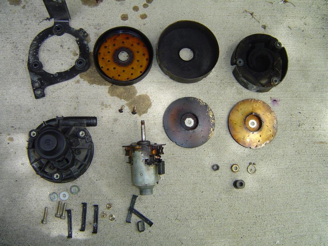

I just went through this. Mine started off with the same codes. What I found is one bank will naturally through a code when the pump is weak. Not necessarily a clogged port though. If it is clogged you can pull the hose off the SAI pump and put a turkey baster of seaform in that hose before the first start of the day. Put it all back together and start it and let it smoke a bunch. That may help. I went through the cleaning process before my pump hard failed and it did not make any difference. Ultimately to test pull the 2-wire power connector off the pump and put 12v to it and make sure you can hear it run. If not pull the pump. If 12v causes it to run or you know it is not making noise at startup, check the pump fuse in the back seat area near the ECU.
I ended up pulling my SAI pump and found that when I popped the cover off that it was full of water and rusted to the point that the impeller would not spin. It is a poor design because the pump intake is open to ingest water and whatever other gunk. And because that pump run very periodically it can rust easily. If you pull the pump you can clean it and unseize it and test with a battery to make sure it spins and reinstall.
