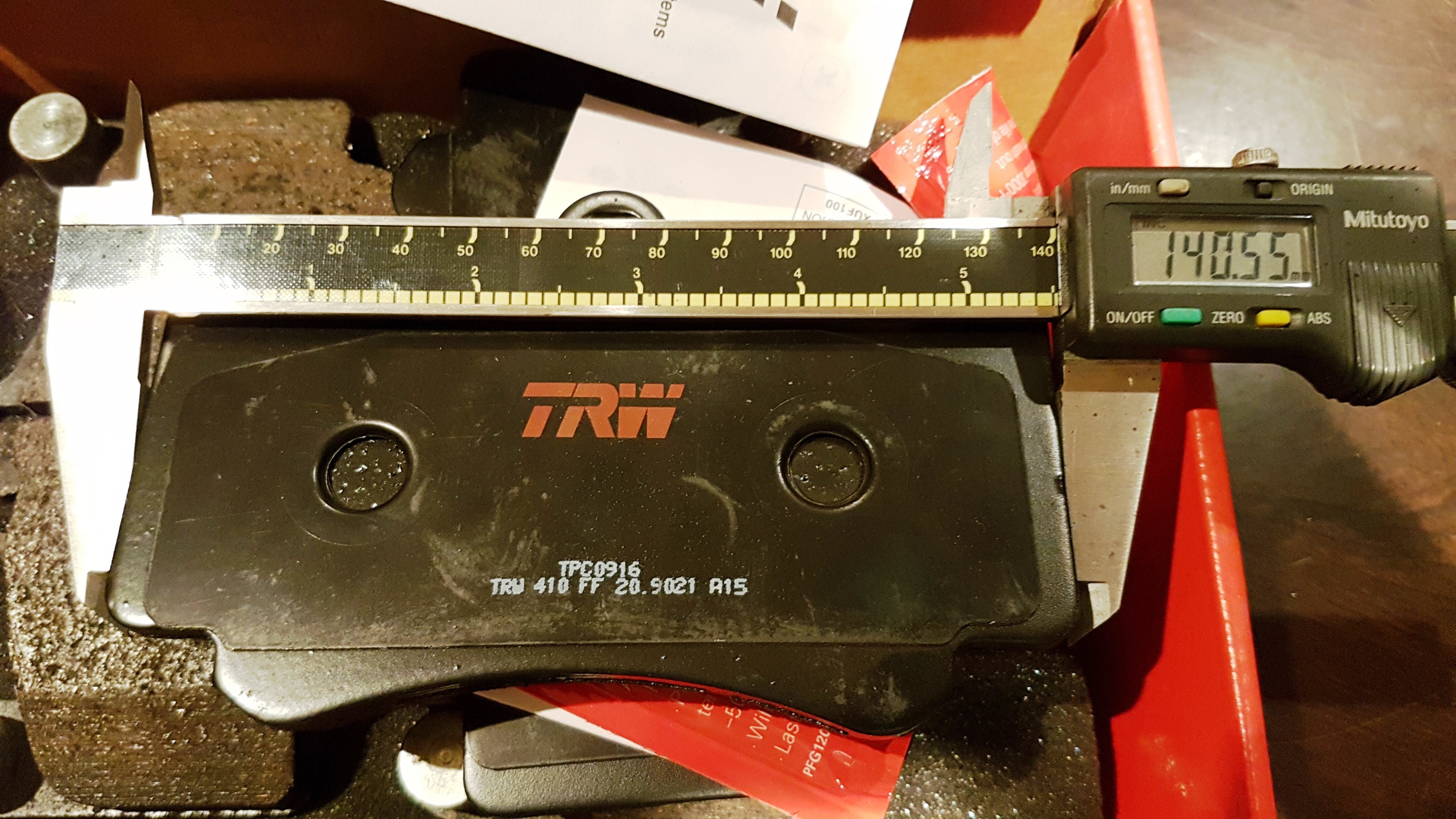

I ordered new Textar pads a while back from Pelican but have not had a chance to install them. I'm hoping to do the install over the weekend. Before I start disassembly I want to make sure I have the right pads. Pelican says they are correct for 996TT front pads but right off the bat they don't have the round weights that my stock pads do and Im having a hard time cross referencing the Textar part number. Anyone have a set of pads lying around that can confirm these at least look the same?

Someone has to have a set of front pads for standard 996TT lying around just to confirm overall shape/size? Thanks in advance

my Textar reference says those are correct. I (think) have a set of oem TRW pads I can check later
Textar no weights, TRW has them

Thanks Rob...appreciate it. For some reason I anticipated they would look longer. I tried to cross reference with Textar but still not 100% sure these are correct. If you could check I'd appreciate it..just don't want to start taking apart until I confirm. Yes, I'm being lazy (but really I have been strapped for time lately).
Thanks again!

I hear ya on lack of time! Hope this helps!
cheers,
Rob

Thanks so much Rob! Looks like I have some work to do this weekend.
