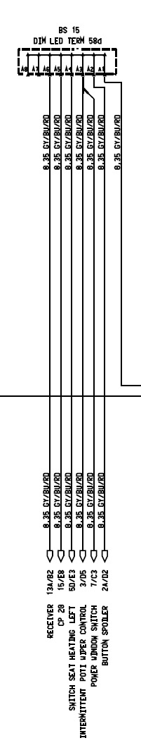

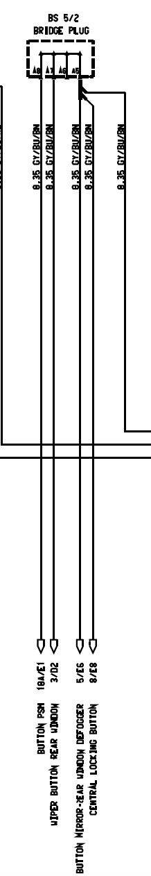

The reason I was asking about the fuse is this component called "DIM LED TERM 58D"... Looks like the power is coming from the instrument cluster and going to different lights in switches....All the same color of wires....There is also another one called "DIM LED 31D" that goes to the bridge plug B/S 5/2....Look at the lights in switches it activate! I wonder if a plug behind the instrument cluster need to be looked at.... I personally never saw this kind of problem before and I was thinking "can it be a symptom of a bad light switch"...Many avenues possible....

Do your lighted makeup mirrors in the visors light up?
The thing connecting all of these switches etc. together is they are all fed power from the alarm module. It also feeds power to the makeup mirror lights. If the makeup mirror lights up that proves the alarm module is providing power.
An aside on the switch lights, 58d, 31d: The cluster provides two dimmer signals for the LED lights in the switches and other places. 58d is variable power, 31d is variable ground. Depending on how the switch is wired up it gets one or the other.

The light in the PSM switch is powered by Fuse E10. Does not appear that anything else is powered by E10. Yes, a 15 amp fuse for one LED. I'd check that next.
The PSM dimmer is the same as the door lock and heated rear window switches which you said work properly. So that points to the E10 fuse.
The light in the spoiler switch is dimmed by the same dimmer as the heated seat switches and the wiper intermittent **** (different dimmer circuit from the other buttons). Do the heated seat and wiper intermittent **** light up properly?
