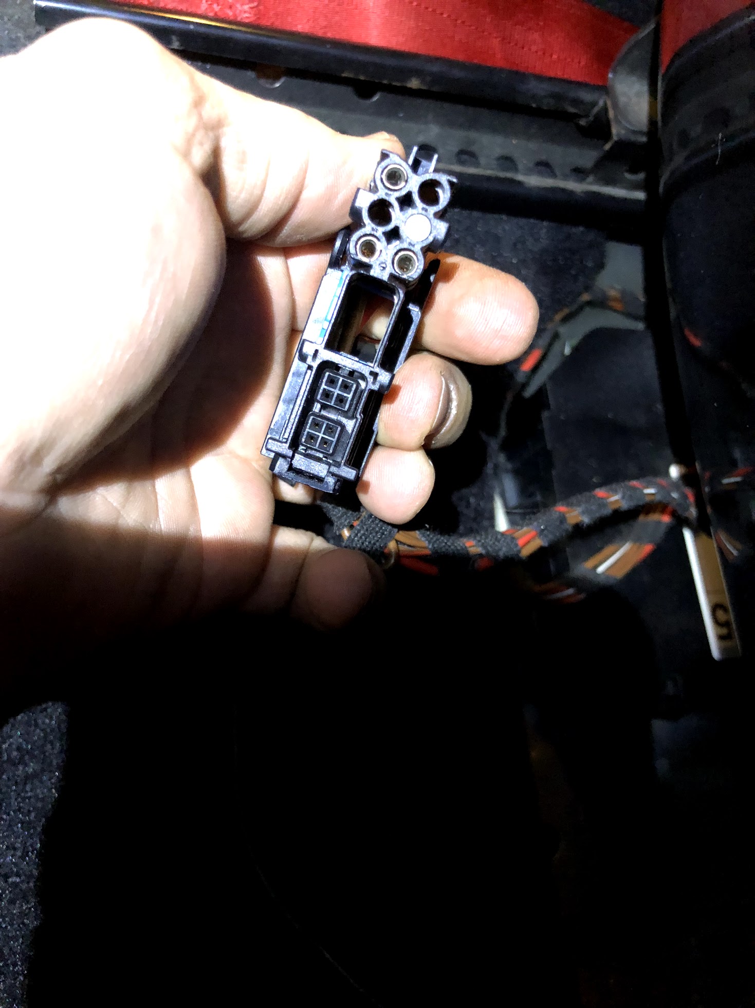

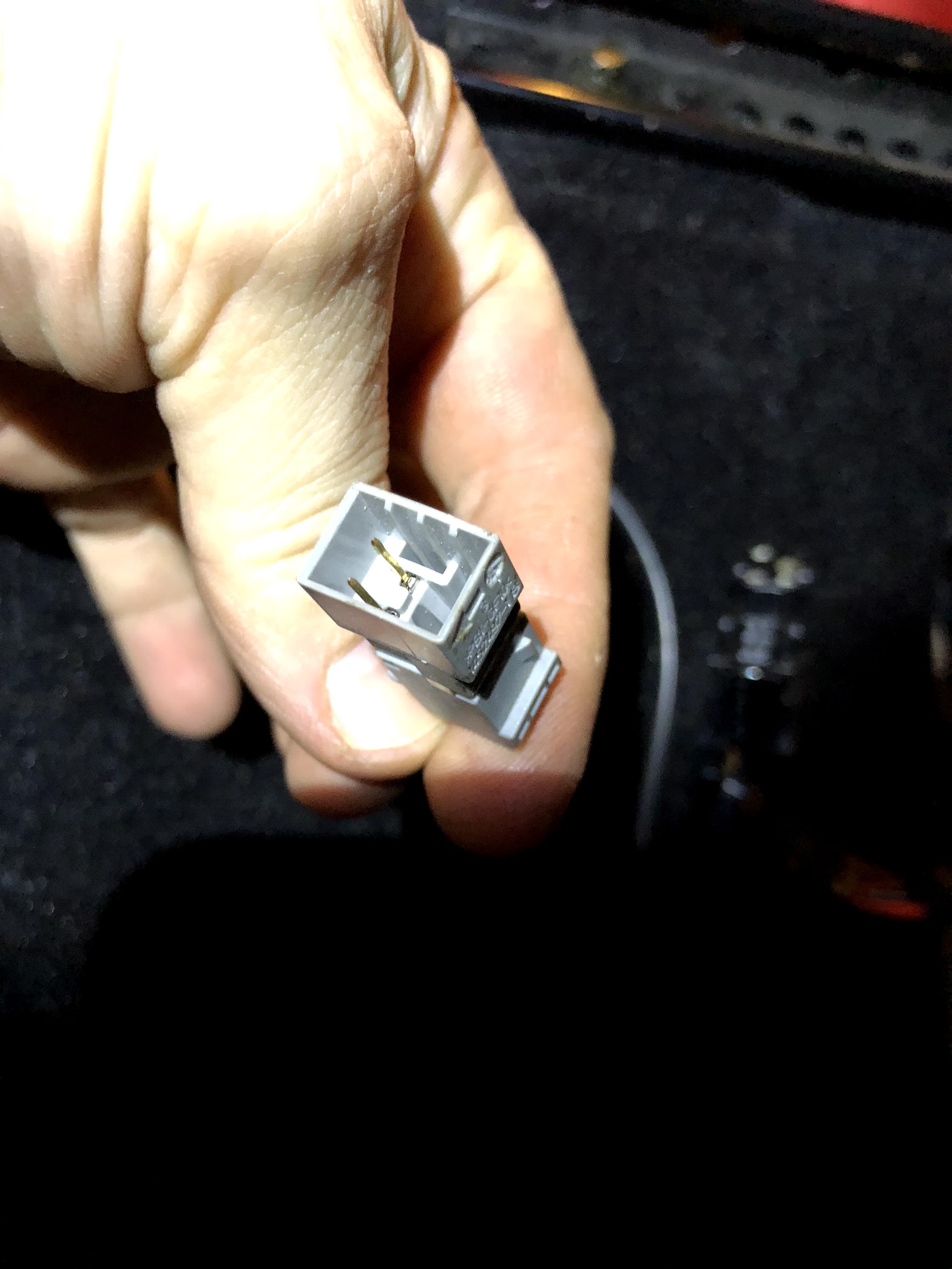

GT3 seats with stock electric harness
I just took out my stock seats from my 996. I have some euro gt3 buckets I replaced them with. Right now there are no connections wired up, the car has an airbag light on, but no seat belt warning. Below are the pictures of the harness that goes to the car, and what comes off the new seat belt buckle. I'm not sure how/if this would go together, since there are alot more places for the wires to go than I have coming out. Any help would be great!

I just pulled the seatbelt off the stock seat, replaced the drivers side. Passenger side pulled the pins out of the harness and plugged them in. Problem. Solved. Should have swapped the receptacles before I put the seats in...
