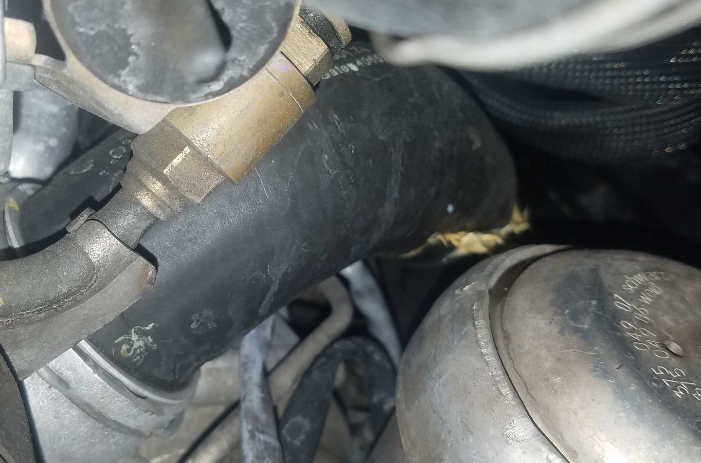

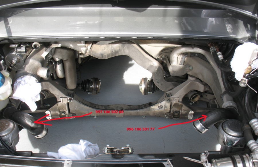

On the passenger side of the motor (since you said the left side was fairly dry) there is a large hose that goes from the front of the motor to the forward coolant pipes mounted to the frame rail of the car. Make sure it didn't pop off or manage to rip itself open.
I have had my 996TT rip itself open on the dyno YEARS ago and I also had the clips in wrong on my brothers 997TT and it blew off during a quick tuning/spirited driving run.
I'm not down at my shop right now so I can't grab a picture of his engine bay (my motor is on a stand currently) but it's fairly easy to spot since it is right by the passenger side motor mount basically.
If that is the hose it is very easy to take off and replace, hardly anything needs to be removed besides the air box (I think). I already had fenderwell intakes when mine popped off and my brothers is the same way, so I'm not sure if the airbox will block working room.

May be this one on the right side Powell mention.....Part# 996-106-501-77

Thank you guys so much. That one is definitely trashed. Hard to see here but there is a crack in it about 4 inches long. Now to get it out!

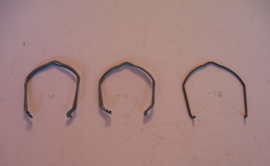

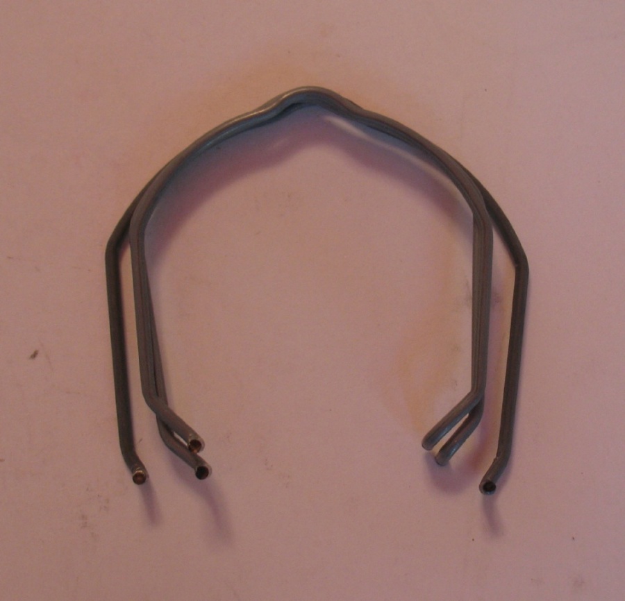

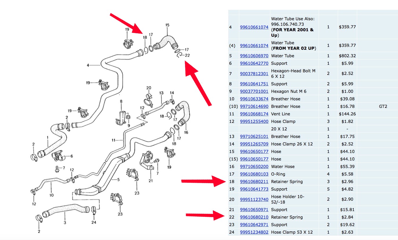

I am sorry I forgot to mention something important. The top and bottom clips are different (see picture and part#) You don't want them to be mixed because it won't hold under pressure!!!!

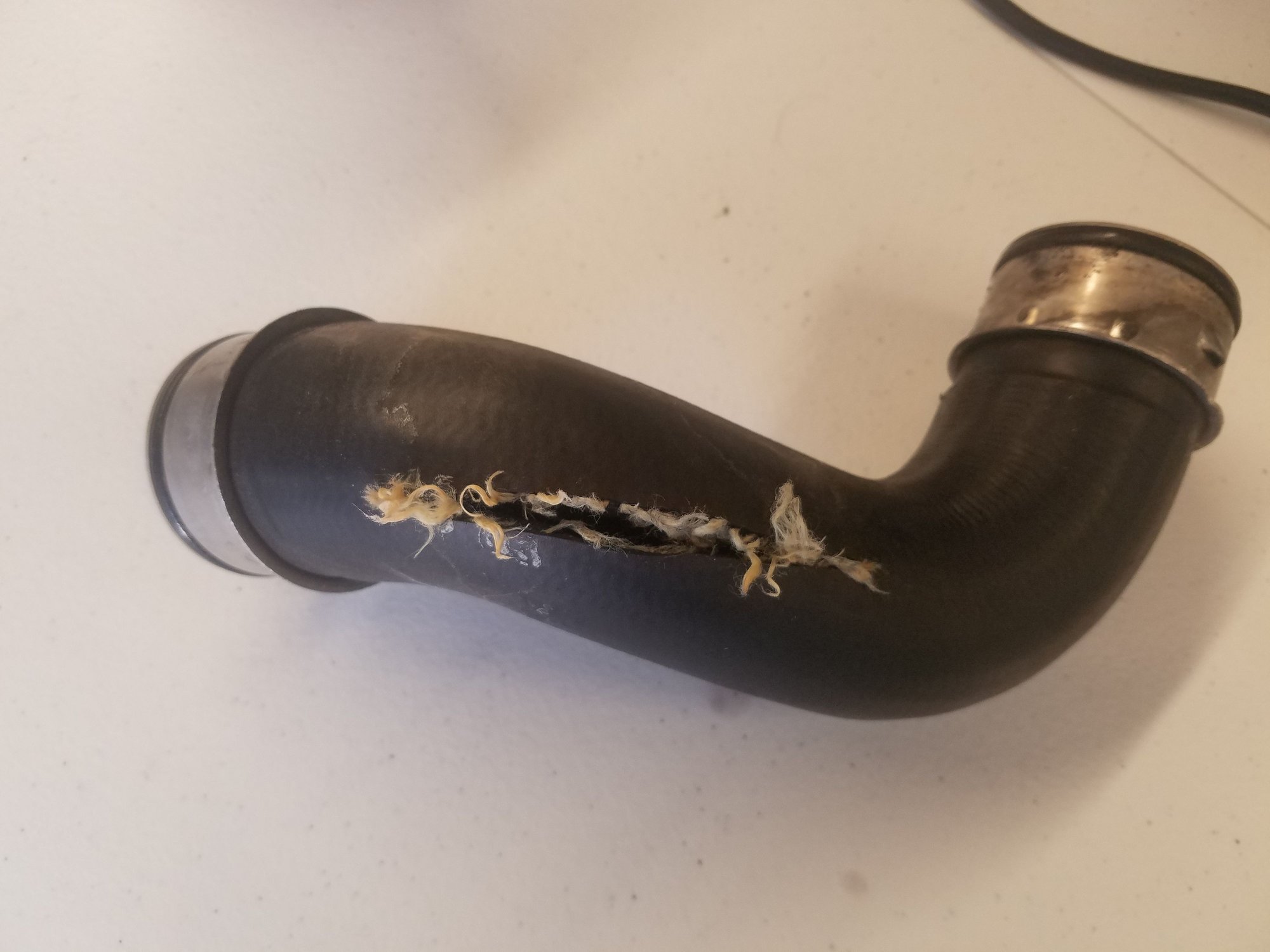

There it is. Salvageable with a bit of duct tape, yes? Pelican Parts has this for just $32.50. I'll be replacing the old reservoir as well since I see it has a crack.
Again, thanks for all the assistance. I would never have realized the retainer springs were different sizes.

I have this same picture in my phone. Mine let loose a few years ago.

Yup mine split open just like that as well. It was on the dyno being tuned on the standalone back in 2009ish and during a low boost pull it just dumped smoke everywhere. My heart sank that the motor had let go (I was already pushing 810-820whp on the stock ECU/stock motor) but when the smoked cleared I saw the rip in the hose and was relieved. I would personally replace both sides as a preventative measure. Just in case the other is getting weak as well. $40 for piece of mind that you shouldn't have to worry about either side.
