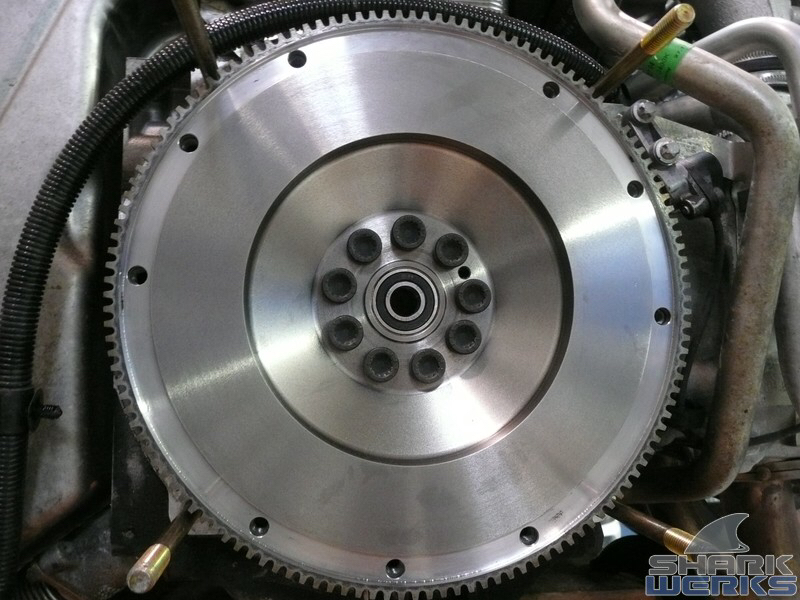

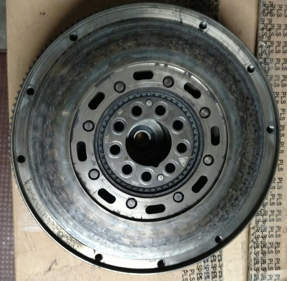

The only parts to be cautious about between the RS parts with regards to the flywheel are the TO bearing guide tube and disk. The RS LWFW disk is designed so that the sprung hub fits in the recess of the LWFW. If you try to flip the clutch disk 180deg then it will hit the pressure plate. Because the dual mass flywheel does not have the center recess dished out there is nowhere for the clutch disk sprung hub to go. You would be better off with a solid center GT3 street or turbo type disk. No need for sprung hub on a DMFW. So the GT3 street solid one would work just fine. Also, look into the Sachs high performance disk for the turbos. These supposedly have better friction material.
Old May 9, 2018 | 09:56 AM
VAGscum's Avatar
Joined: Oct 2008
Posts: 1,696
From: Portland Oregon
Rep Power: 188
VAGscum Is a GOD !VAGscum Is a GOD !VAGscum Is a GOD !VAGscum Is a GOD !VAGscum Is a GOD !VAGscum Is a GOD !VAGscum Is a GOD !VAGscum Is a GOD !VAGscum Is a GOD !VAGscum Is a GOD !VAGscum Is a GOD !
Here is a picture showing the LWFW dished center and a DMFW for comparison.
