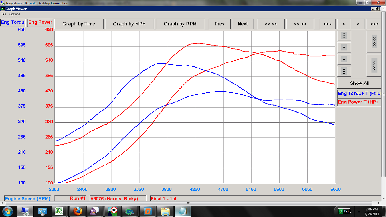

this was my EPL build from about 8 years ago - havent been around the 996tt community for years - curious what a build wld like today and what wld you change/update from this list. the Europipe 2 loud has proven to be too loud for me so will most likely look for something easier to live with.
TiAL Alpha3076 Turbo Kit
996tt - Turbo Install Kit
8.5 Labor - 8.5 Hours - Turbo and water line
6 Labor - 6 Hours - Fuel injector install
Clutchmasters 20-934-HDTZ Stage 3 Clutch
12 Labor - Clutch and flywheel installation
OEM Dual Mass Flywheel - 996
9 Flywheel Bolt -
Clutch Lever Shaft Cap -
Clutch Lever Bearing -
Europipe 2 loud
2 Clutch Lever Shaft Seal -
2 Release Arm Bushing -
USP 996TT High-Flow Inlet Pipes
3 Labor - 3 Hours - Inlet pipe installation during clutch install
AWE Tuning 996tt Intercoolers (Silicone Hose kit included)
1 Labor - 1 Hour - Trim OE shrouds to fit AWE I/Cs
2 I/C Hose O-Ring - 996 1
6 Spark Plug - Bosch FR6-LDC
6 Ignition Coil
Serp Belt -
Fuel Filter
996tt GT2 Clutch Delete
996 - Brake Lines - 4 wheel kit
Front Brake Rotor - Upgrade to 350mm
Rear Brake Rotor - Upgrade to 350mm
Bilstein PSS10 Coilovers
Motor Mount Install
2 WEVO 997 SS Engine Mounts
GMG 996TT World Challenge Sway Bar Set
4 Custom Adjustable Front & Rear Endlinks
Titan Standard Issue DV
