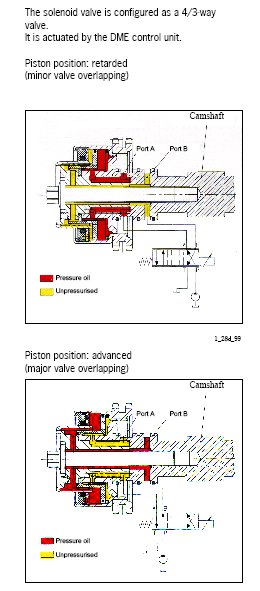

Functional description of camshaft adjuster
The camshaft adjustment system is based on the
principle of a helical sliding gear which has a
cylindrical component (3) between the camshaft
gear and camshaft stub.
The cylindrical component has helical gearing both
inside and outside. The inner gearing engages with
matching gearing on the inside of the camshaft
gear (4). The outer gearing engages with gearing
(2) mated to the camshaft stub. At the same time,
the cylinder (3) forms a piston on the side facing
away from the camshaft. This piston can be moved
by oil pressure. A number of teeth have been
removed from the gearing to ensure that the oil
pressure can act on the piston instantaneously
without loss. The component is sealed with a
sealing ring (1) and cannot be dismantled. The oil
pressure is regulated on both sides by means of a
4/3-way valve.
Is this the issue? Oil is used as a control fluid to advance and retard the VarioCam Plus. A thinner oil would transmit quicker pressure changes in the solenoid?

That is one of the many issues. In short yes.

The High Temperature/High Shear Test(HTHS Viscosity, mPa·s @ 150º C, ASTM D 4683) for mobil 1 shows the viscosity as follows:
0w40 3.6 centipoise
15w50 5.11 centipoise
Surely that would effect oil pressure control response time
