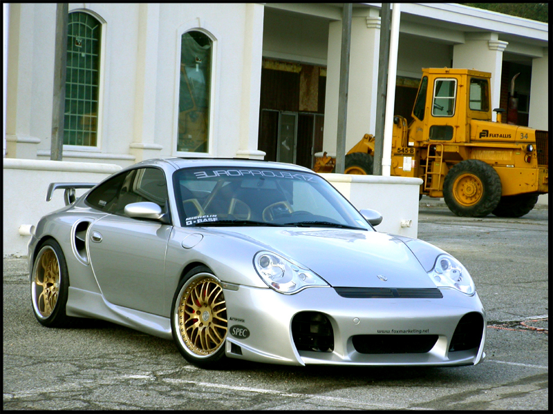

Originally Posted by Cody_1
Sharky has posted a pic some time ago of his black TT with gold BBS magnesium wheels on. You may want to hit him up for a pic. Not center lock, but will give you an idea.
- Rich
Got you covered, here are some pics of Alex's car with them, he's actually selling them on his site too!
