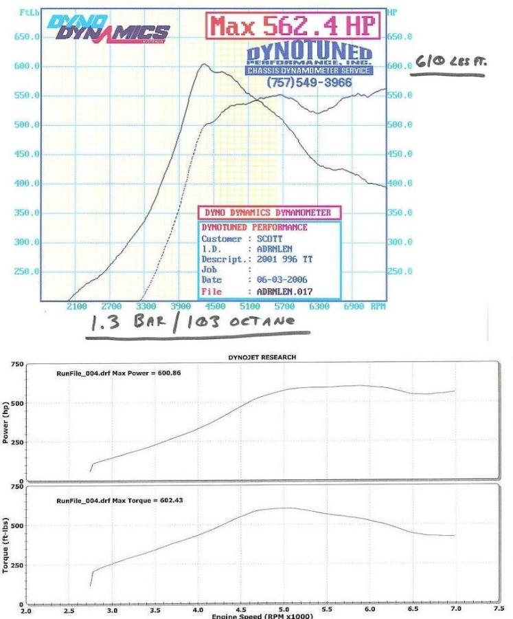

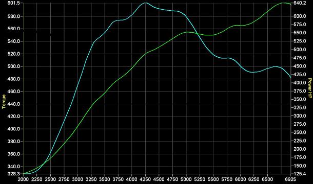

Carver, excellent points.So, unless you are specifically building a 1 dimensional car to maximize any 1 of the above points 1,2,3 or 5, shouldnt the general discussion of turbos in a given class/price range shift to avg power and tq across the power band- point #4.The avg forum member here is most likely looking for info on a flexible,multipurpose turbo that has great performance at the 1/4 mile, road course and street work ,but specifically excels at none of those. I know I fit that target market since I track, drag and still need a car that my wife drives 5K miles a year.It now becomes a "power under the curve" debate and some tuning kits excel at that and some dont. If so why would one give away the lower part of the band in a 24/18G turbo? Be good , Kevin
Have you driven any cars with those wonderful K24/18G turbos? If so, how do you quantify lag in them vs. what you know? Maybe they are not daily drivers that our wives can drive? Or the benchmark is that if you are in 6th at 20mph and you smash the throttle the car takes 1 more second to get to 150mph?
Is your statement based on what your dyno graph analysis showed you so accurately?
Would you like to see the same car with the same setup however with 20% more torque "under the curve" only because it is being run on two different dynos? So what might be the secret?
We need to hear new selling lines.
Jean, my good friend ...for someone who routinely complains about this site...you sure do spend a lot of time here debating dyno sheets etc, but hey you are part of the family. Since you lost the point of MY post to K24 Madness, I will hold your hand thru it one more time...He made a statement , pure and simple, that Proto 24 hybrids are superior to Kevins Hybrids....his words, not mine. Now , like I said previously just forget the dyno numbers and look at the HP line, and only the HP line...His solution shows no additional power being made from about 5K to redline, yet Kevins "inferior" hybrids pulls all the way to redline making power the entire distance. Again, this is just a response to that post and if you have an answer to that I would love to hear it...Just remember, forget all the variables and concentrate on the trend line and on the fact these two kits are making roughly the same power from 2 different tuners at roughly the same price point. Why would you take a solution that stops making power at 5K?
As for the selling line...I am not looking to buy a 3A or an 18G so I am not sure what point...if any , you are trying to make. Be good buddy. Kevin
