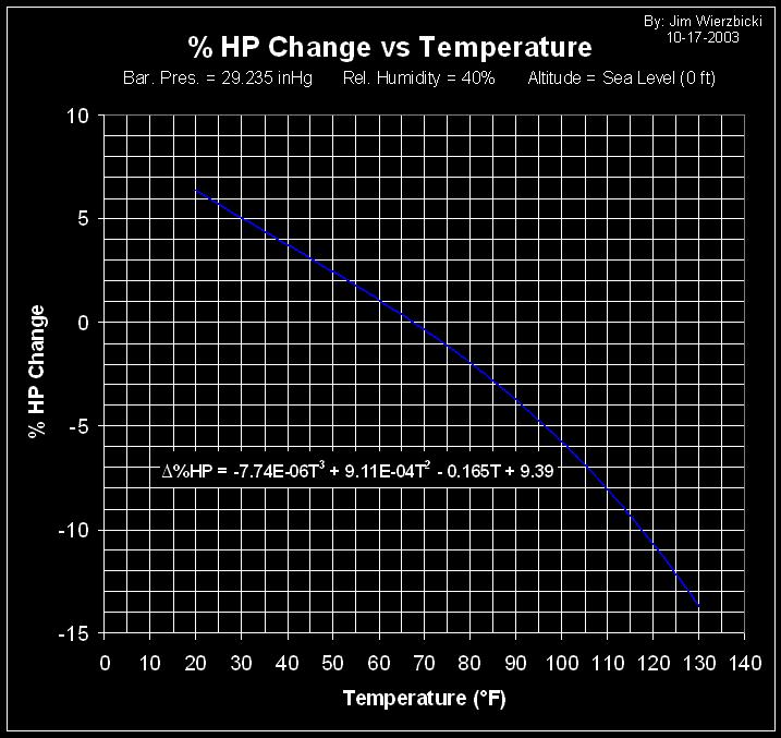

What you are saying about the air is partially correct. Our tests have shown that once the ambient air temperature is below 65 degrees F, the hp gains are almost none detectable. In addition, as the ambient temps drop the hp gains are not proportional for every ten degrees.

The Porsche head studs 175,000 psi test. EVO head studs 175,000 psi test. The EVO head gasket is superior to the Porsche head gasket abeit you will drop approx. 2/10's compression. The grooves and copper ring method Markski is using is borrowed from the 993 motor and work very well. There is a stronger head stud currently available. I have used all three.
The new ARP head studs I am using are 230,000 psi!!!
EVOMS' multi-layer head gasket is more than sufficient for all but the most extreme applications. This new copper head gasket is even better. Moreover, it is thinner, so I will not lose any compression (I may actually pick up a tad of compression).
Craig
