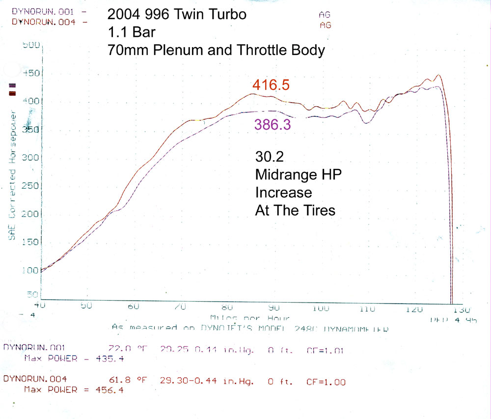

Quote:
I don't mean to be a sceptic, but show me a a base line dyno and then a dyno with the new intake. 25 hp is alot. A slightly larger intake and 25 hp? Is it all across the power band? Does it give you peak horsepower at a certain speed? 140 to 160 mph? I'm sorry, but I find it very hard to believe Porsche engineers left 25 easy horses on the table.Originally Posted by TKDalumni
That part alone was good for 25HP.
The intake plenum is a part made by innovativeprodesign.com (check the website for the dyno sheets and pictures). Basiclly, porsche left this intake plenum as a T shaped air splitter which creates a lot of turbulent air. This upgraded plenum turns it into more of a Y shaped air splitter which increases airflow to the cylinders. I saw Mike(owner of innovative pro design) doing dyno pulls on the GT3 with this plenum and if i remember correctly he was gainig around 11hp. I think he claims more like 13 or 14hp for the turbo cars but check the site for more accurate numbers.
I notice that is at 1.1 bar. Doesn't seem like a stock program. Was the baseline done with or without the stock program. There are so many variables and information, or lack thereof, to show a clear benefit. How long was the time lapse before each pull? Which pull was done first? Is it the same car? What was the temperature? See what I mean. From what I understand, they are increasing airflow. What is the difference in the airflow from the stock intake vs. the modified intake? How much are these plenums running 1000.00 bucks? I need more proof and information than that.
I just posted what was on his website. I think he has air flow diagrams also to go along with the dyno charts(not sure if they are on his site or not though). Ya,you are right, that is not a stock progam if it's at 1.1bar(I agree that it should be a stock program).
Eric's info about the T vs. Y design is correct. My dyno runs were done with GIAC programming, exhaust, and K16/24's. One pull with that equip. then installed the plenum, about an hour, then did it again. 24HP midrange gain beween 3500rpm and 5500rpm. I have no reason to lie, if there were no power benefits then I would have taken it off. All these "little" things add up. Thats why I got 500rwhp on these little 16/24's!
