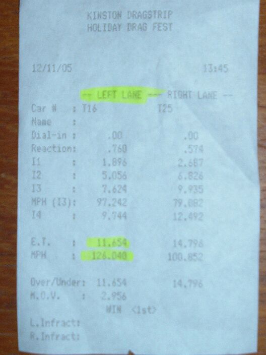

Not only did my car trap 125 and 126 mph...but I also beat a X50 car with a Stage 1 chip from a roll 3 times in one night. We were both racing a 615 rwhp Cobra at the time. I posted the video here a while back.
Anyway, I have no absolutely no doubt that, for whatever reason, my car at the Stage 2 level was definitely making more than 500 crank HP. But I'm not saying that other Stage 2 cars are making the same power.

Scott, I am not debating the trap speed, which I know is true of course, what I am saying is that either trap speed means little in relation to Hp and there is much more to it or if this trap speed means 600HP, your car was not on stock K16s, this is physics not dynos or trap speeds.
Do you have the slip for that run, I would like to look at the acceleration between your 330ft and quartermile. Please PM if you wish.
No reason to PM you. That slip has been posted on the forum ever since I made the run. Here you go:

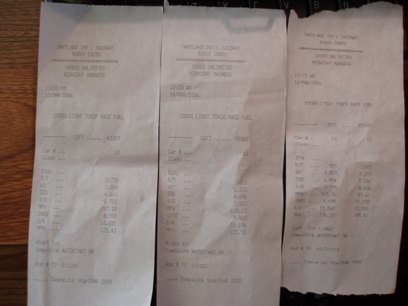

E.T., yes. Trap speed, no. It's not really dependant on launch like you'd think. That's why cars with stock tires will routinely trap the same as they do on drag radials or slicks...even though their E.T. is is greatly reduced by the stickier tires.

For me when the same car covers in the first run a distance of 60 feet at 60mph and then in run number 2 it covers the same distance at 65 mph, the end speed will certainly be faster in run two, unless in the balance of the 1280 feet distance something goes wrong with the car
Let me give you an example of what I mean.
Here is a link to the timeslips of (3) 10 second runs I made with my car. You'll notice that the run with the highest trap speed (136) was also the run with the slowest E.T and slowest 60' time (10.86 & 1.85, repectively). I actually spun my tires and got wheelhop on that run, which is why I lost 2/10's of a second and had a slower 60' time.
Also look at the 1/8th mile mph. I only had 103 mph at the 1/8th on that run compared to 107 and 108 mph in the other two. But I still trapped the fastest mph on that run.
That's what I mean when I say that trap speed isn't really dependant on launch or even the 1/8th mile E.T/trap that much. It's relies on pure wheel HP once you reach the end of the 1/4, and nothing else.
