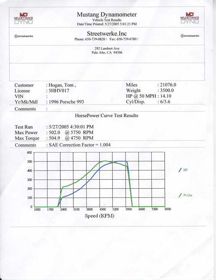

This is from my 993tt running 1.2 bar of boost with K24 hybrids. Expect 75-100 more whp on a 996tt with much better bottom end (due to 4 valves and variable cam design)
Nice numbers, but that is a 993TT...not a 996TT. Two totally different animals. Do you have any numbers from a 996TT so we can compare. Thanks, Kevin
