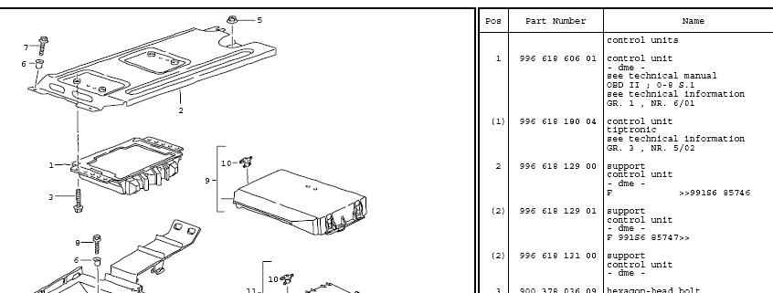

Can someone confirms what part is sent to be reflashed.
Is it 996-618-606 ?
I'am considering a GIAC but change cars fairly often.
Could I buy a standard ECU and change it back if I sell the car and save the re-flashed unit for the future ride.... Providing it is a 2001 to 2005 996/TT I assume.
Thank's in advance for the enlightenments!
Pic of the parts catalog.

It is 996-618-606..
There are two ways to flash the ECU:
1. Remove it and send it off to a tuner.
2. Take the car to the tuner and flash through the OBD2 port.
You can purchase another ECU (flashed/stock) and switch them out.
