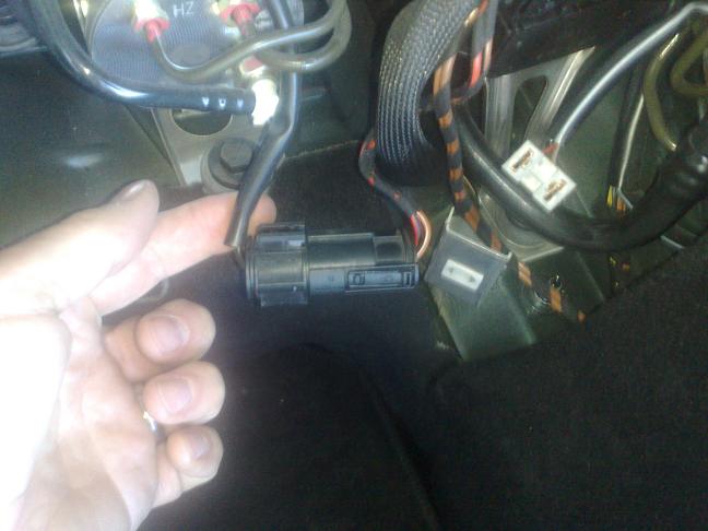

I have this problem on my car as well and I found out that it's the PSM unit that gets "spunky" for some reason. The problem happens when I'm going fast and braking hard on a bumpy surface or braking in a fast turn. I solved the problem by disconnecting the electrical line to the pre-charge pump this disables the PSM fully but keep the ABS system fully active.

I got a PM from 996TT_STEVO but I'm not allowed to answer him(smart function? NOT!). It is the cable that goes from the ABS unit to the pre-charge pump, the pre-charge pump is located under the Brake master cylinder. The ABS unit is FULLY Active.

I don't think this is a problem with the ABS unit because when I disconnect the Pre-charge Pump for the PSM unit the brakes and ABS works just fine. I think this is a problem with the PSM.
I love you for this post...... Seriously.
