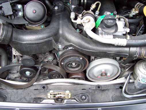

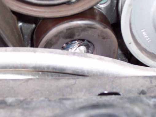

I checked the belt and it is indeed broken, however, it was caused by a broken pulley. I have attached two pics (the lower one showing the broken pulley). I can go get a replacement from the dealer, however, I do not know how to get the metal crossmember off to get at the bolt. Ideas?
Thanks!
Old Apr 25, 2004 | 01:15 PM
skaria's Avatar
Joined: Aug 2003
Posts: 108
From: Westport, CT
skaria is infamous around these parts
here is the broken pulley:
Old Apr 25, 2004 | 10:32 PM
ebaker's Avatar
Joined: Aug 2003
Posts: 910
From: TX, USA
Rep Power: 59
ebaker is infamous around these parts
Looks like the bearing siezed. Will the dealer fix it under warranty?
