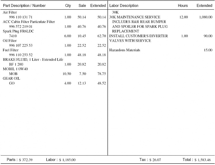

I recently purchased my 2003 996TT with 31,000 miles on it. The used car dealership I purchased it from said it had just been "serviced" but I am pretty sure all they did was change the oil. That means it needs the 30k mile service. I contacted a local independent repair shop that works exclusively on German cars, and they quoted me a price of approximately $1,400 for the 30k service including labor and parts.
Their quote included all of the following parts:
Cabin Filter Particulate Filter
Spark Plugs
Oil Filter
Fuel Filter
Brake Fluid
Engine Oil (Mobil One)
Gear Oil
I recently installed a new air filter myself so I didn't need them to change that. Does this seem like a reasonable price? I am also going to have them install new diverter valves for me at the same time, which they are going to charge me $90 to do.

The bulk of the charge is 12 hours of labor at $90/hr including the removal of the rear bumper in order to replace the spark plugs. How many hours of labor were you charged for? Sounds like it would only be 1 or 2 hours if it only cost $300.

Here is the estimate they gave me. Should I just go elsewhere, or try and negotiate a more reasonable price? Is the real problem how much they are charging for labor or are they trying to screw me on the parts, too?

Thanks for everyone's replies. I called one of the local dealerships here in Atlanta and they quoted me $1,150 so I guess I'll stay away from that independent shop I contacted first. The most expensive part of the service is definitely the spark plugs apparently.
