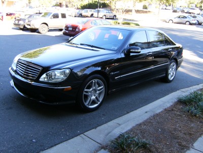

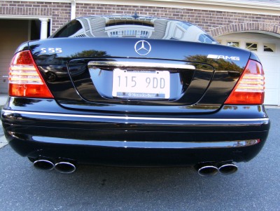

I had to buy a daily driver.. so until we figure out whats going on with further action (if any), I picked up an S55 AMG to ease the pain.
