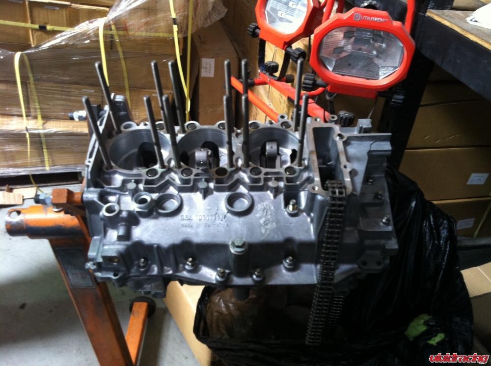

We have instock this complete Porsche 996 Turbo Short Block with a 4.0L stroker kit for sale. We were building the engine for a client but they ran out of money. The short block is in perfect condition. We have already assembled the crank and rods as well as sealed the case. The sleeves, pistons and rings have not yet been installed. All parts are brand new.
This auction includes the motor as pictured, new crank, rods, pistons, rings, Darton Sleeves, modified oil pump for larger crank, new case gaskets, and bolts.

The next part of the 996TT stroker kit is the rods. The rods maintain the OEM dimensions. These rods are also 4340 billet steel which are VERY strong for high horsepower. To further their function and strength, they are equipped with ARP fasteners. The center to center measurement of the rods is 5.00in. The big end bore is 2.284in and the big end width is .744in. Finally the pin end bore is .905in. As a OEM replacement to the Porsche 996 Turbo short block, all these parts fit without issues. However do to the stroke, part of the oil pump housing must be ground down (see photos).
