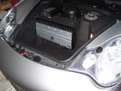

This is a pic of the JL Audio 450/4 amp that was in my C4S. Sounded great, but took up too much space. Plus you're always dinging it up when ever you load stuff in you trunk.

here's a bigger pic

damn that's a big amp! what style of music do you listen to? i'm guessing LOUD.
