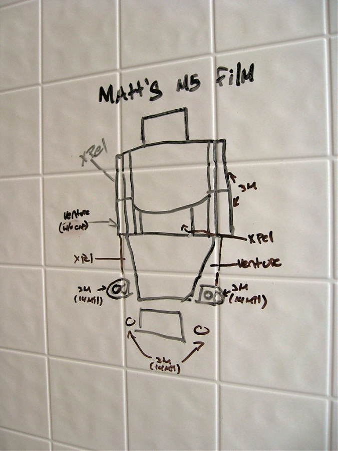

We've been doing PPF for the last 8 years and only custom cut for the last 6 years; but in my opinion X-Pel (aka Invisishield and Reflex) does have the best pre-cut kits. Up to last month, X-Pel used 3M film but at SEMA came out with their own version of a clear-coated film. The film itself is more delicate thatn the others - softer squeegees and milder application solutions have to be used. I have it on my M5 as well as 3M Scotchgard and Ventureshield clear-coated film to test out their durability in the real world. I gotta be honest, once applied on the car the difference in orange peel as well as gloss is virtually indistinguishable between the three films. They were all waxed with the same sealant - DyNA Brilliance paint sealant. Here is a diagram showing which pieces were done with which film. I will update on the results as time goes by.
As far as installation is concerned, all things being equal, custom cut is always better in that it allows more complete coverage as well as eliminating many of the seams and relief cuts. Just make sure that the installer is experienced and proficient in installing the custom kits and trimming the film on the paint. You should have some very good installers in your area as it is the busiest as far as film installation goes in the country.
