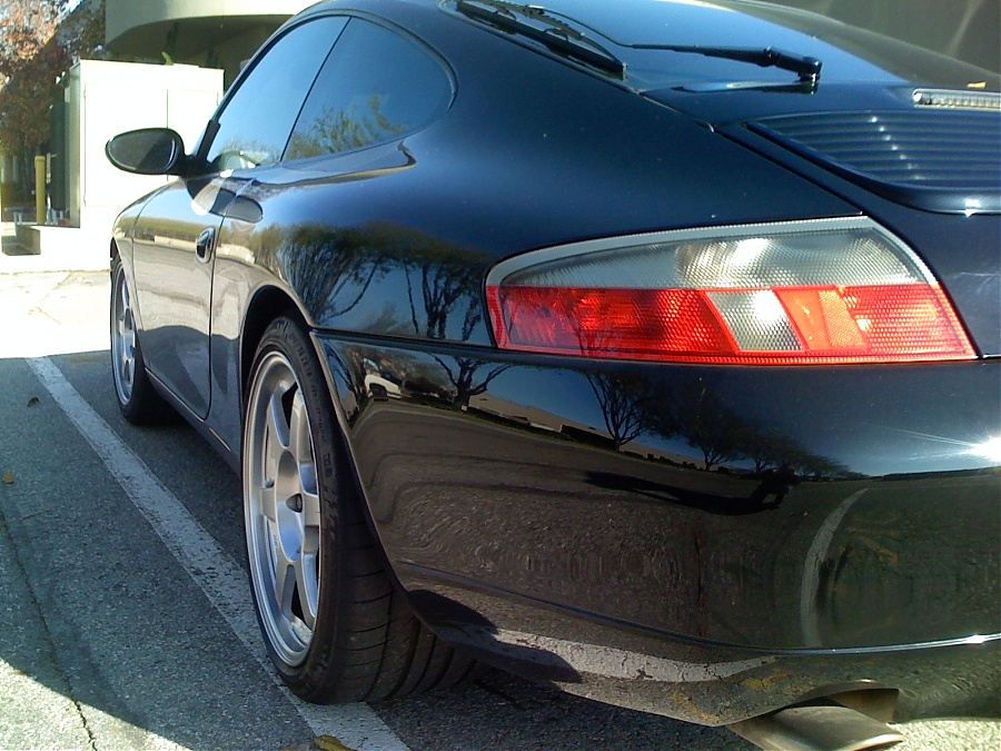

I have 11" rears with (295/30/18) with either 59 or 60 offset and they just fit flush. I have -2.0 rear camber.
